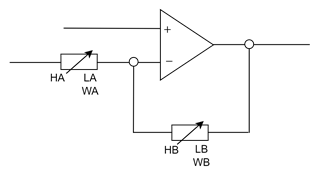

My customer is considering the following usage of TLP0102-100.

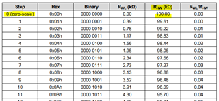

1. How can the customer estimate the gain tolerance (= ratio of resistance A and B)? Can it be calculated by Rtot.match and MATCHrm? If yes, could you please express the formula?
2. Is the connection of HB and LB/WB are correct, or needed to be inverted? (meaning should LB/WB be connected to negative input of the op-amp?)
