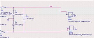

We are planning to use ADC16DV160 with transformer coupled front end design. We got S1P file for ADC from TI query.
But we are having issues during ADC simulation load impedance port assignment. ADC16DV160 have P & N pair signals for one channel but we only have one S1P file.
Q1) Can you confirm that this S1P file values obtained for ADC-(P or N) channel alone (or) ADC Total input impedance across P & N pins?
Q2) How to connect out front end circuit with ADC'S S-Parameter file?
Q3) Can you provide proper method for ADS simulation for ADC16DV160 termination?
We attached reference circuit for Reference.

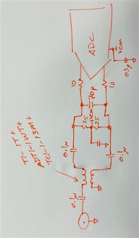

  • Hi Esakki,
    No you cannot simulate SNR/SFDR. With all that you outlined above, here is what I would recommend.
    Rob

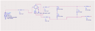

  • Dear Rob,
    We were connected ADC front end simulations in ADS simulation as per attached image. For further return loss and Insertion loss measurement we need connect out front end circuitry with ADC input impedance.
    How to connect the ADC input impedance with IF front end circuitry?
    Please guide us for further process.
    Esakki.
  • Hi Esakki,
    I would use a parallel R||C value based on the input frequency of your application.
    This can be found on the S11 plot, in figure 31, on page 20, of the datasheet.
    Rob
  • Hi Rob,
    From the smith chart shown in S11 plot, in figure 31 of datasheet, we found that impedence of ADC input shall be
    28.325-j*274.979 Ohm. How to find the parallel R||C value for my 70MHz IF input frequency.
    Esakki.
  • Hi Esakki,
    I understand the issue.
    I am checking with design to see if they have the sparam files for figure 31. and the aggregate R||C values for the analog inputs.
    Otherwise, we need to do some iterative guesses to find the R||C based on the complex number you stated above.
    Rob

  • Hi Esakki,
    If you can estimate the R||C values, you can use this paper to help. it has an example to go by.
    Basically you will use a shunt inductor in front of the ADC's analog input to resonate away the internal C, this will create a natural BP filter at 70MHz.
    Rob
    https://www.analog.com/media/en/technical-documentation/app-notes/an-935.pdf
