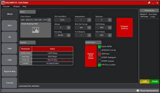

    Sorry for my late reply ,but I have been unable to continue with tests until today. I will try to describe our setup, and configuration used.
    - Serdes rate : 10.65Gbps
    - Data rate : 8.52Gbps
    - FPGA clock : 133.125 MHz (the GUI give us a wrong value (double as expected)). Below you can find a screenshot of GUI
    - No SYSREF used
    /resized-image/__size/320x240/__key/communityserver-discussions-components-files/73/pastedimage1734007910033v1.png
    In addition, we add the log with register values loaded on DAC for you to check if something is wrong with configuration

    What we see in registers through GUI is:
    - Register LANE_STATUS[9] (0150h) is 0x01, which means that lane 9 is detecting a data signal
    - Register LANE_ERROR[9] (0160h) is giving us the value 0x02, which means that there is a disparity error
    - Register BER_CNT_REGISTER[9] (01B0h)  goes to 0xFF immediatly after run the test
    Maybe we have forgotten to configure any other register required, or one of the ones we have configured have no correct values for the test we want to carry out. So we would appreciate if  you can have a look on the log file and see if something is wrong or missing.
    Of course, If you need more additional data, please, let us know and we will provide you the information as soon as possible.
