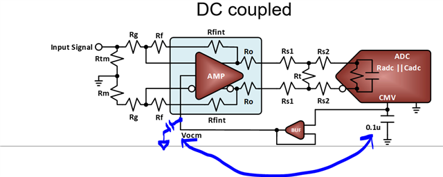

Hi everyone.
I've seen in the datasheet that both internal and external VREF may be used. In case of using an internal VREF, the capacitors shall be installed on VREF pin.
Does it mean that there's VREF voltage (1.6V) on VREF pin that may be used externally?
I have differential ADC driver with input from ADC VREF. It uses VREF to clamp the output voltage.
