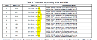

The DAC108S085 in my design is interfaced to a SPI port on a TMS320F28379S.  The SPI's clock polarity and phase is set to SPI_PROT_POL0PHA1.
I am noticing the Analog output value is 4 times the computed value.
What could be causing this issue?  The issue also occurs for other clock polarity and phase settings.
