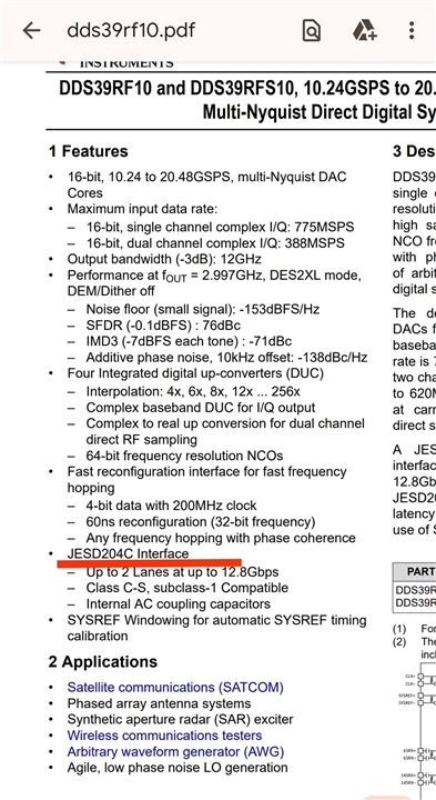

    However, I noticed in the datasheet that it mentions JESD interface support. Please find the relevant snapshot attached for your reference.

  • Hey Balu,
    The DDS39RF10 has two SERDES lanes that are active. So JMODES 4, 5, 6 and 7 are supported. How much Instantaneous bandwidth did you need for your application?
    Matt
  • Hey balu,
    Just a few things to add. The DDS39RF10 does not have its own EVM. What we recommend to customers is use the DAC39RF10EVM and just limit to 2 SERDES lanes. The GUI will be able to tell you how many SERDES lanes you are using based off the number of I/Q streams you are sending to the DAC as well as the JMODE. The DDS39RF10 and DAC39RF10 are the exact same die and will perform exactly the same with the exception of the active SERDES lanes.
