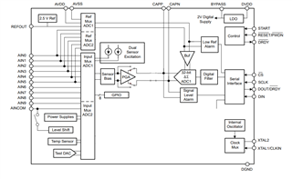

hi Sir
we would like to design a meter for thermocupler, old design is use ADI/AD7780
We would like to design the next gen product, spec as below
did you have any advise?
thanks
2 CH
ADC:Pin-Programmable、24bitGain 16 or 32
 R-TYPES-TYPE Resolution is 1℃,
Measurement Range:
J-TYPE (0.1°) -210°C to 1200°C (  -346°F to 2192°F)
K-TYPE (0.1°) -200°C to 1372°C (-328°F to 2501°F)
T-TYPE (0.1°) -250°C to 400°C (-418°F to 752°F)
E-TYPE (0.1°) -150°C to 1000°C (-238°F to 1832°F)
N-TYPE (0.1°)        -200°C to 1300°C ( -328°F to 2372°F)
R-TYPE (0.1°)    0°C to 1767°C (32°F to 3212°F)
S-TYPE (0.1°)    0°C to 1767°C (32°F to 3212°F)
  • Hello Chen,
    ADS1285 is not the best part to use for thermocouple measurements.  It can be used, but it is optimized for seismic monitoring.
    For highest resolution and data rates up to 38ksps, ADS1262 would be a great choice.
    Another excellent choice is the ADS124S06, supporting 24b and data rates up to 4ksps.
    Both of these ADC's have everything needed to support thermocouple measurements.  Also, I recommend looking at the below application note for temperature measurements.
