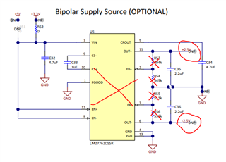

    It appears that the circuit for supplying ±2.5V externally to the ADS1261 on the EVM is not implemented. Is it possible to input ±2.5V externally?
    Yes you can apply the +/-2.5V externally. You would need to remove the crossed out components below, then apply the signals to the circled test points. Note that these test points are not installed by default on the board, but they are labeled on the EVM

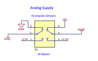

    You also need to ensure that S1 is set to the correct position (to +/-2.5V)
