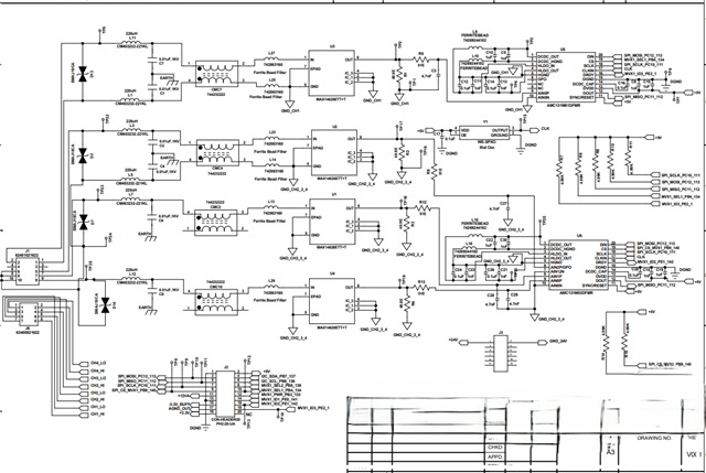

I am using an STM microcontroller to control the AMC131M01DFMR using SPI. I have enabled the DCDC bit, and the CIN frequency and divider are set to default. A continuous clock is provided at CIN after power-up. After that, write register and read register commands are sent for configuration, with only the DCDC bit enabled while keeping everything else at default. However, I am not getting any voltage at the DCDC output. What could be the possible reasons for this issue?
  • Hi Omkar,
    What is the application?
    Can you provide the following info on your system:
    1. What is the CLKIN frequency you are using
    2. Can you share the schematic
    3. Do you have captures of the digital communication
    Thanks.
  • The CLKIN frequency is 4MHz. I am attaching schematic for your reference.

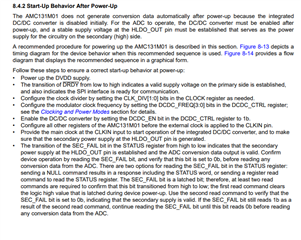

  • Hi Omkar,
    The DCDC_Freq register has to be set according to the CLKIN frequency before enabling the DCDC_EN.  The DCDC won't turn on properly unless the frequency setting is correct.
    Thanks.

  • Hi Omkar,
    The DCDC_Freq selection in Table 8-31 is actually incorrect.  It's from a previous revision that was missed when updating the datasheet.  Please refer to Table 8-3, the one I responded with above, for the DCDC frequency setting.  Hopefully that fixes the issue.
    Thanks.

  • Hi Omkar,
    It looks like the responses to your writes don't match up.  Can you scope out the SPI signals to verify the data sent?
    Thanks.
