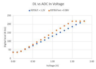

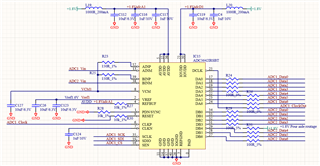

I'm stil working with the ADC3642 and I have some interrogation about the input range of the ADC as working on single-ended mode.
We use a input signal range range 0.3V to 1.5V but the results we got are ... a bit strange. Maybe I miss something.
  • 0.0V --> ADC Code = 2 384
  • 1.5V --> ADC Code = 11 903
  • 1.8V --> ADC Code = 14 000

I checked my configuration by reading ADC registers and everything is fine.
I tried to change the REFBUF voltage pin by using either the 1.2V internal or a 1V external and none of them changed the behavior as expected.
(NB: 8-bit MSB are used on figure above)
If I understand correctly, my signal should saturate (0 or 16383DL) when outside the range [Vcm-0.56 ; Vcm+0.56] (regarding the Datasheet page 29) and Vcm is set to 0.9V (measured with a multimeter). So ...
Voltage < 0.9 - 0.56 ==> < 0.34V ==> ADC Code = 0
Voltage > 0.9 + 0.56 ==> > 1.46V ==> ADC Code = 16383
It seems the output value range from the ADC3642 is limited.
Can you please help me to get the full range ?
