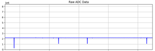

Basically, when i plot the data from the ADC, i get occasional spikes when it should be a constant:
Note that I am plotting the raw value from the ADC here.
another example:
I have ensured that I am in the correct SPI mode, and am waiting for the DRDY pin to go low before polling for the data. This problem gets significantly worse (more spikes per 100 samples) for a lower OSR or a different filter, or if i decrease the delay in my main loop in code.
Due to this, it makes me believe it is a timing related issue, but per the datasheet i am using an spi clock of 2MHz which falls well within the range of acceptable values for a 3V power supply, and i am using the correct SPI mode. I am waiting for DRDY to go low before making a measurement, and i am delaying my loop by 1ms.
Is this likely to be a timing issue? If so, how can i fix it? or have i somehow damaged my ADC while soldering (note I have two which exhibit the same behavior)

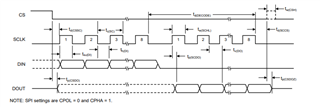

    The ADS127L01 SCLK idles low, launches data on the SDO pin on the SCLK rising edge, and captures data on the SDI pin on the falling edge.  You may want to confirm that your SPI port is configured to capture data on the SCLK falling edge.   This is the most common description of SPI mode 01, but some processor families have a slightly different definition.
    Yes, this could be a timing issue, or simply a signal integrity issue.  You will need to use an oscilloscope to measure the /DRDY, /CS, SCLK, SDO to confirm both timing and clean signals.  If you could include an image of 2 full sequential frames with these signals, this will help to confirm.  (Also, SDI should be held low when reading conversion results.)
