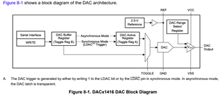

1) can you help to review the schematic?
2) toggle mode register A and register B, where is it? It's not in register map.

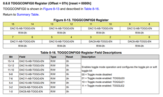

3) toggle pin, only 3 pin, does it mean we can pick up 3 of 8 channel use it?

  • Hi Liping,
    [Sanjay] - Please see the regmap for toggle config. You can assign each of the channel to any pin independently.
    TOGGCONFIG0 and TOGGCONFIG1
    Sanjay

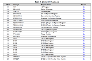

  • point 2) ,  DACx has only one register for each channel ; If we toggle, we need two register A&B to switch.
    But from below table, I can not find.
  • Hu Liping,
    Please have a look at the figure 8-1. Each DAC channel has two internal register Reg-A (DAC Buffer Register) and Reg-B (DAC Active Register). Both of these registers are written via DACx Register. The procedure to write in Reg-A and Reg-B, is described in the section 9.4.1 Toggle mode. Please go through it once, it will be clear.
    To update the toggle registers the following sequence should be followed:
    1. Set DAC channel in synchronous mode and disable toggle mode for that channel
    2. Write the desired Register A value to the DAC data register
    3. Issue a DAC trigger signal to load Register A
    4. Write the desired Register B value to the DAC data register
    5. Enable toggle mode to load Register B
    I hope this will clarify the doubt regarding the toggle mode Reg-A and Reg-B write.

  • Hi Sanjay,
    I am not sure the register A or B address.
    Please take table 7 I attached for example.
    For channel 0, the address is 14h.
    This is register A or B?
