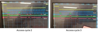

  • Hi Sanjay,
    I tried reading the DEVICEID register. I do not think I am getting the correct values. Based on the arduino code above, I am performing 3 SPI cycles as shown below. I am not writing the GENCONFIG reg.
      write_reg(0x03, 0x0A04); //SPI_CONFIG reg. 0x0A04 to enable SDO - update at rising CLK edge
      delay(1);
      //reading DEVICEID reg 0x01
      write_reg(0x81, 0x0000); // bit23 is 1 for READ command
      write_reg(0x81, 0x0000); // extra access cycle to read data
    Here are the screenshots from the oscilloscope of the 2nd and 3rd cycles:
    I have confirmed the first access cycle (not shown in image). The SDI is correct. It reads hex 030A04 (as expected)
    I checked the voltage supplied to the DAC. The VDD, IOVDD are at 5V. AVSS at -10V. AVDD at 10V.
    Please let me know what i am doing wrong.

  • Hi Sangik,
    SPI frame and power supply looks to be okay.
    Please try these two steps, and let me know the results.
    1, Write 0x0A04 to reg 0x03 and 0x0000 to reg 0x04, then read both of these addresses and report the readback data.
    2. Measure the VREFIO pin voltages and report the measured value, it should be 2.5V.
    If you are not getting the 2.5V, we need to have a live debug session to see what is going wrong here.
