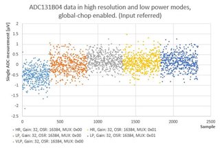

While testing the ADS131B04, different offset voltage levels on channel 1 were observed using different power modes while the input pins of channel 1 shorted externally.
Shorting channel 1 input via the MUX1 register shows an equal offset between both 'high resolution' and 'low power' power modes.
Global-chop was enabled in all modes so a typical offset of 0.4 µV was expected.
AVG STDEV
Settings [µV] [µV]
HR, Gain: 32, OSR: 16384, MUX: 0x00 -16.8 12.3
LP, Gain: 32, OSR: 16384, MUX: 0x00 0.1 12.1
VLP, Gain: 32, OSR: 16384, MUX: 0x00 7.2 10.6
HR, Gain: 32, OSR: 16384, MUX: 0x01 4.0 11.5
LP, Gain: 32, OSR: 16384, MUX: 0x01 4.7 11.9
Noise levels are close to the typical noise as specified for the ADS131B04-Q1.
What could be the reason that while the pins are shorted externally, the 'high resolution', 'low power' and 'very low power' modes show such different offset levels (resp. -16.8, 0.1 and 7.2 µV)?

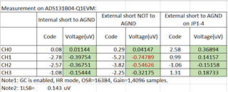

    I did a test on the ADS131B04-Q1EVM. As you can see the result from the table below, shorting the inputs to AGND internally or externally shows a similar result that matches the specification as well, however an external short not to the AGND shows a little higher offset error on some channels, but they still meet the min/max specification of the offset error.
    I suggest you to do a similar test. If your calculation from code to voltage is correct and your measured offset error is much higher than what I measured on the EVM, that indicates that your circuit or PCB board design can be improved. The measured offset error should be close in different mode as I checked, it may be higher than the typical specification a little as specified in the datasheet but it should definitely be within the min/max range.
    BR,
    Dale
  • Dear Dale,
    Thank for checking with the evaluation board: offset errors seem very good and according to specifications indeed.
    In our solution, the 'External short NOT to AGND' shows an average voltage of 16.8 μV (code of 117.4, LSB 0.143 μV). So much different to the values you showed with the evaluation board.
    Analog and digital ground are only connected to each other under the ADS131B04-Q1 and channel 1 inputs are connected across a 22 μOhm shunt resistor in our design. (one side of the shunt is at the analog and digital ground potential) A filter circuit quite similar to the datasheet is present between the shunt and channel 1 input pins.
    In the offset error tests, differential filter capacitor C563 was shorted, so quite close to the channel 1 input pins.
    Note, adding common mode filter capacitors C562 and C566 (both 10 nF) worsen the offset error to about double the value (28 μV) while the differential mode filter capacitor C563 is still shorted. So there may be something here but I fail to see the root cause.

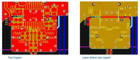

  • Dear Dale,
    The PCB is four layer. All lines to the ADC are routed on the top layer and one layer below is a continuous ground. There are no other switching lines under the ADC or under the input lines on other layers. 188.7 is indeed the mean code. This is the mean of 500 samples. In the past we've collected much more samples but the mean and standard deviation did not change significantly above 500 samples. A new single data point for the mean is collected every 500 ms. Total data collection time thus spanning just in excess of 4 minutes with 500 unrelated samples collected to determine the mean and standard deviation (noise).
    We do not use a LDO but a buck converter to supply the ADC. There is a low pass filter on the Avcc input. I've already disabled the boost converter on the PCB, cut the power supply to the ADC and supplied the 3.3 V with benchtop laboratory power supply instead but results were the same.
    Strange thing is that also with MUX1[1:0] register set to 0x01 gives an offset error measurement of around 4 μV in our case while I would expect it to be like the values you showed with the evaluation board.
    I tried to switch the inputs too: both channel 1 inputs have a 2 k input resistance (tried 1 k and 200 Ohm too with no effect) and a 100 nF differential capacitor close to the pins. The positive input would be on about the AGND side of the shunt like in the typical circuit in the datasheet. Switching the resistor connections to the PCB on one side, thus switching the inputs (negative input on AGND side of the shunt) showed a lot of effect in offset error while measuring. Though still not close to the typical expected values:
    Switching the inputs would have no effect when the inputs are shorted externally or internally. I mention this as an additional observation hoping that it may give a clue in the cause of the offset error differences that we are observing.

  • Hi Dries,
    Thanks for your clarification on the clock. I previously showed my test result on the EVM in high-resolution mode. I just did one more test in the different mode on the EVM, please see the result below. There is a slight variation with external short in different modes, but all of these results meet the specification of offset error (+/-4uV max/min when the GC is enabled) as shown in the B04 datasheet.
    From your latest test result that is shown in the image you shared, most of your test results in HR/LP/VLP mode are within -1.5uV ~1.5uV, all of them are within -2.2uV to +1.5uV, your test results meet the specification too. Your test data in HR mode with MUX=00 are a little bit smaller than other conditions, but this matches my test result on the EVM. I did not see any problem as long as they meet the specification of the offset error.
    Let me know if you have any other question.
    BR,
    Dale
  • Hi Dale,
    Thank you for your research. Agreed that each value is within specifications. This was also our conclusion, but what we found strange was the difference in offset error between power modes and internal and external shorts. (Which is also observed in your previous post. e.g. ch1, -0.410 and 0.109 µV for internal or external short. and 0.109 and -0.691 µV for the different power modes)
    Our initial expectations were that with an internal short it would be possible to determine the offset error and that this offset error value was more or less valid for an external short and for other power modes too.
    If the power mode and internal and external shorts have unrelated offset errors, but all according to the ADS131B04 specifications, the offset error determined with an internal short could be 2*4 =8 µV (max. offset error in global chop for ch1) or a typical 0.8 µV deviating from the actual offset error of an external short.
    All is clear now and the topic can be closed.
    Kind regards,
    Dries
