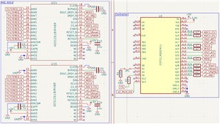

I’m working on a project where I designed a custom PCB that uses two ADS1261 ADCs to measure differential voltages between 16 electrodes. Here’s my setup:
  • Electrode Wiring:
    • ADS1261 #1: Electrode 1 to Electrode 10 are connected to AIN0–AIN9 respectively.
    • ADS1261 #2: Electrode 10 to Electrode 16 are connected to AIN0–AIN6, and Electrode 0 (the wrap-around electrode) is connected to AIN7.
  • ESP32 Connections:
    • Both ADS1261 devices share the same SPI bus. I have connected:
      • /DOUT_DRDY (from both ADCs) to MISO (GPIO19)
      • SCLK to GPIO18
      • DIN to MOSI (GPIO23)
    • Chip select pins are separate: ADC1 uses GPIO14 and ADC2 uses GPIO15.
    • Additionally, I have tied the START, /RESET, /PWDN, and /DRDY pins of both ADCs together (this might be an issue, but i think with the right addressing i can work around this).

  • Hi Balazs Hazi,
    Can you provide logic analyzer captures of the data communication during the initialization? Please include DIN, DOUT, SCLK, CS, DRDY, RESET, START, and PWDN
    -Bryan

  • Hi Balazs Hazi,
    The quickest and best way to diagnose these types of code / communication issues is with a logic analyzer. For example, it is possible that your code is perfect but your SPI mode is set incorrectly, and therefore the ADC will not respond to any command. And not all controllers use the same convention for SPI mode, so you cannot just rely on setting SPI mode = 01 and then assume it is good, you really need to check
    There can also be timing issues that would not be identifiable in the code, you really need to see what you are sending to the ADC and how the ADC responds to detect any issues
    When you do get a scope, you should first try powering up the device, applying the clock (if not using the internal oscillator), pull the START pin high, and then probe the DRDY pin. You should see the DRDY pin toggling at ~50Hz because the default data rate is 20 SPS. This is a good indication that your device is powered correctly and the clock is working, which is the first step
    Then, start small: send the RESET command and make sure the ADC response is exactly as it is shown in the datasheet. Then try reading a single register whose default value is non-zero e.g. IMUX, and see if the response is exactly as it is shown in the datasheet. Then write a single register and read it back. At that point, you should be able to identify the issues you are having with the code and then expand it to do what you want
    -Bryan
  • Hi Bryan,
    Sorry for the late reply, this week has been a lot of trial and error. I figured out some flaws in my design and after correcting them i followed the steps what you just described above. That was very helpful, and i got my ADCs working by this step-by-step "tutorial" :).
    Thank you very much for your help!
    Balázs
