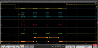

Part Number: ADS8341
Old uC is CR16MCS9VJE7/NOPB
New uC is FS32K146HAT0MLHLHR
Both Old and new uC’s are configured with External clock 2MHz. But in new uC, we are not getting expected results. Internal clock is working fine.
We tried with following combinations:
- External 1 MHz
- External 2 MHz
- Internal 2.4 MHz with External 1MHz
- Internal 2.4 MHz with External 2MHz

CH0 – Input to ADC (Refer Voltage Column)
CH1 – Constant 2.5V
CH2 – GND
CH3 – GND
CHcom – GND
Vref,SHDN,VCC1,VCC2 - 5V
