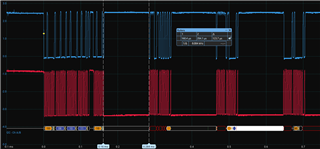

Figure 24 suggests that the clock stretch time is tconv * OSR_CFG[2:0]. There are a few things wrong with this, 1) how does this take into account the cycle time, 2) the value stored in OSR_CFG[2:0] isn't actually the number of samples averaged.
I'm wondering if the clock stretch time should actually be tcycle * 2^OSR_CFG[2:0]
For my configuration this would give 8 us * 2^4 = 128 us. Here is a capture of SDA and SCL confirming this time.
As others have identified, the TLA2528 datasheet contains errors. Is this another one? When can we expect a corrected datasheet?

    I think I see what you are saying and how it's not totally clear. OSR_CFG[2:0] doesn't directly contain the samples averaged together. Like in your case, your register setting is 100b (4 in decimal), which corresponds to 16 conversions. Maybe it could be clarified that it is not the actual register setting, but the corresponding oversampling ratio selected. I've taken note of this as a potential update.
    t_conv should likely be updated to t_cycle, according to the OSC_SEL and CLK_DIV[3:0] register field settings, since t_conv is only defined as t_stretch, which is only defined for one-shot conversion mode.
    Your interpretation is definitely correct, and is what the datasheet is intended to state, so there is room to improve how that is communicated. At the moment there is no timeline to when the datasheet will receive a revision, but this is definitely something that will prompt any changes and be included in the next one.
