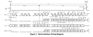

According to the ADS8684 datasheet, valid SDO width in the worst case is tHT_CKDO + tSU_DOCK = 10ns + 25ns = 35ns.
I understand that as the frequency of SCLK decreases, the valid SDO width will increase.
Is it possible to provide the time from SCLK rising edge to SDO valid like DAC8775 datasheet?
Thanks and best regards.

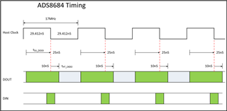

  • Hi Zhaoyu,
    Welcome to our e2e forum!  I can't change the timing of the ADS8684 to look like the DAC8775, but maybe this will help to visualize the timing:
  • Thank you for your answer.
    From the timing diagram you drew, is my understanding correct : Even if the frequency of SCLK is reduced, the valid SDO width in the worst case is still 35ns?
    As shown in the figure, when the SCLK frequency is reduced to 12.5MHz, the valid SDO width in the worst case is 35ns.
    Or, to be more extreme, when the SCLK frequency is reduced to 1MHz, the valid SDO width in the worst case is 35ns.
    In other words, the valid SDO width is independent of the SCLK frequency.
  • The SDO is intended to be read by the processor on the falling SCLK edge.  A slower SCLK will give more setup time (longer valid time) but it won't increase the hold time.

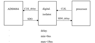

    In this application:
    The digital isolator will cause a delay in the signal from input to output, with a maximum delay of 18ns and a minimum delay of 0ns.
    CLK period is set to 60ns (50% duty cycle).

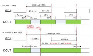

  • Hi Zhaoyu,
    If you slow down the clock, yes, your setup time technically will increase.  You need to consider the max delay through the isolator on the way in for your SCLK and for SDO on the return trip.
  • Hi Tom
    "A slower SCLK will give more setup time (longer valid time)"
    Does this mean that if the SCLK period is longer as shown in the figure below, the valid time will be longer by the same amount as the longer period (58.824ns in the figure below)?
  • Yes, that is correct.
