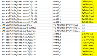

Hi everyone!
How to Use ADS7138 Autonomous Mode
After following the flowchart on page 25 of the datasheet, I noticed that when I set the threshold value lower than the current input voltage, the ALERT signal does not change. I also checked the EVENT_FLAG register, but no flags were triggered.
Could you please help me check if there is any issue with the following initialization steps? Thank you.
GR,
HC

  • Hi Hsuan Chia,
    Rather than sending the code, are you able to send logic captures of your configuration sequence probing the I2C lines? This helps to verify that the code is executing the expected values at a low level.
    Joel
  • Hi Joel
    The following are the settings and operation methods. Each time an I2C is written, an I2C is read. And attach LA log.

    I try to read the High/Low Flag. When I set the following, the Event High Flag is triggered. Why ?
    EVENT_RGN  0x00
    High Th 0xffe
    Low Th 0x001
    Hysteresis 0x00
    Event_count 0x00
    Event Flag 0xFF
    Event High Flag 0xFF
    Event Low Flag 0x00
    Recent CH 0 0xffc0
    Recent CH 1 0xa7c0
    Recent CH 2 0x2780
    Recent CH 3 0x2a10
    Recent CH 4 0x38b0
    Recent CH 5 0x5c60
    Recent CH 6 0xa900
    Recent CH 7 0xfe70
    GR,
    HC
  • Hi HC,
    Apologies for the delay again. I was out of office for a majority of the last week.
    So it seems like you have set the high and low thresholds close to the extremes of the input. Can you clarify if the high and low thresholds are applied to each channel, or just channel 0?
    Since all of the channels are showing the high flag, can you check the MAX_CHx register values?
    What was the sequence that the high and low thresholds were set, when the event flags were read, and when the recent channel registers were read back?
    Provided the MAX conversion values exceed the high threshold, this seems to be working correctly. My biggest concern is that the sequence that the registers were set might have set the high thresholds inadvertently.
    Joel

    I temporarily set all channels to the same threshold to test the alarm function.
    The values ​​are as follows:
    1. Set high and low thresholds
    2. Read the recent register
    3. Read event flags
    GR,
    HC
