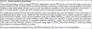

I am trying to measure 4 load cell's data (4 differential outputs; unipolar supply) at 400 SPS with gain 64 for a force platform. I have designed a breakout board for ADS1261 to connect all the load cells to it, amplify the raw data, and do the A/D conversion.
In the Schematic (the attached file), you can see that I have hard-wired the START, RESET, PWDN pins to DVDD and the CS pin to GND to keep the ADC always powered on, active and selected for serial communication. Now I am trying to establish the SPI communication between ADS1261 and Teensy 4.1 MCU. Teensy has a default SPI bus comprising pin 11(MOSI), 12(MISO), 13(SCLK) and 10(CS). Teensy's pin 11 (MOSI) is connected to the DIN pin of ADS, pin 12 (MISO) to the DOUT of ADS, pin 13 (SCLK) to the SCLK of ADS, pin 10 (CS) to the GND and pin 2 (GPIO) to the DRDY of ADS. I have defined all the necessary register assignment and Commands for conversion (you could check the attached code text; it is for one channel) still the ADS is not responding and MCU is reading some garbage values. Note: only one ADS is connected on the SPI bus, the bus is not shared among multiple slave devices. No internal reference is set, AVDD is set as reference. ADS chip id is getting identified as 0x81.
I am unable to understand where I have done wrong. It would be great if you could help me to resolve the issue.

  • Hi Charles Jebaraj,
    Can you please provide logic analyzer data showing the communication between the ADC and your controller? Please include CS, DIN, DOUT, SCLK, and the DRDY signal.
    This will allow us to see what you are sending to the ADC and how the ADC responds, as well as check timing (which is not evident from your code)
    -Bryan
    I am not sure how to help without being able to see the communication. It is possible your code is correct but the communication timing is off. You will not be able to determine this just by reviewing the code.
    You will need some way to monitor the communication to at least check the timing requirements are met. But this will also help diagnose communication issues in general
    Also, I would not recommend holding CS low. Any glitch on the SCLK pin could either be interpreted as an additional SCLK period or a missed SCLK period, throwing off the entire communication. Yes it is possible to tie CS to ground, but again, not recommended because you must be very careful with the communication
    -Bryan
