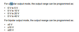

I searched for a high-speed DAC by sorting as shown in the following URL, but I could not find any product that can use unipolar output and bipolar output separately.
https://www.ti.com/ja-jp/data-converters/dac-circuit/high-speed/products.html#84=14%3B16&596=125%3B24000&1345=2%3B4&1498=Catalog&1918=Parallel%20CMOS%3BParallel%20LVDS&sort=1130;asc&
1. Is it correct to understand that DAC5687 and DAC5672 only use unipolar output?
2. Also, could you introduce products that satisfy the following conditions?
・Parallel interface
・Sampling rate: 125 MHz or higher
・Resolution: 14bit and 16bit
・Number of channels: 2~4
・Output: A device that can be used between unipolar and bipolar.
