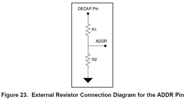

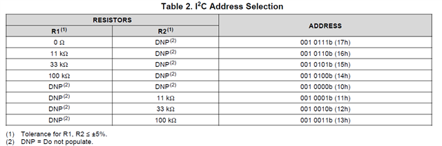

I have a question about the ADDR pin:
In the pin description I found that this pin can be connected to GND
But in the section  "I2C Address Selector" it appears that this configuration (R2 = 0 / R1 DNP) is not valid
What happens if the ADDR pin is connected to GND?
