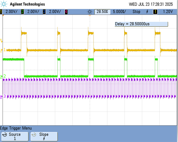

We are currently using five ADS7066IYBHT devices in a daisy chain configuration:
FPGA → ADC0 → ADC1 → ADC2 → ADC3 → ADC4 → FPGA
We are trying to write 0x80 or 0x8A to the GENERAL_CFG register (Address: 0x01) of each ADC to enable the internal reference and perform offset calibration.
The protocol used is SPI-00 (default), and the SCLK frequency is 1 MHz.

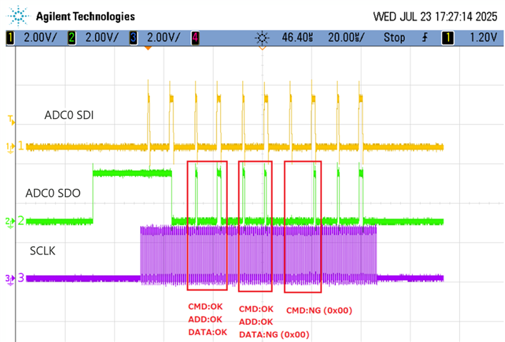

After sending the data 0x080180 (24-bit) from the FPGA to ADC0, the SDO output from ADC0 seems to show proper command/address/data timing. However, for ADC2, ADC3, and ADC4, the timing of the data output on SDO becomes misaligned, and the GENERAL_CFG register write does not succeed (the received command and data are 0x00).
We have attached oscilloscope waveforms showing this issue.

We suspect that the issue may be caused by insufficient number of SCLK clocks when sending data to all 5 ADCs.
Since the chain consists of 5 devices, we believe that 24 bits × 5 = 120 bits of SCLK are required in a single SPI transmission to propagate data correctly through all devices.
However, we are currently sending 24-bit command/address/data (0x080180) sequentially 5 times, which may not be enough to allow the downstream ADCs to receive and pass on data via SDO.

      4. Daisy chain does not require register configurations, maintaining the CS low, providing sufficient SCLKs, and connecting the devices following Figure 7-7 in the datasheet is all that is required.
    • 120 SCLKs should be enough for 5 devices.
      1. When the device continues to receive SCLKs while the CS remains low in goes into daisy chain mode and outputs what came in through SDI through SDO.
      2. So in your case with 5x devices, the 1st 24 SCLKs will write to device 0, maintaining CS low, the input will not be seen on SDO0 until the next 24 SCLKs like we see in the image you shared. Meaning that device 1 will have the command sent during the 25-48 SCLKs, device 2 during 49-72 SCLKs, device 3 73-96, and finally device 4 with 97-120.
      3. If you would like to readback the value in your FPGA then an additional 24 SCLKs would be needed.

    • Aside the throughput it would be important to make sure that the set up and hold time if SDI are met (t_su_ckdi & t_ht_ckdi respectively), again with 1MHz I wouldn't think this would be an issue, but making sure would be good.  The bigger concern would be if the devices were far apart and the SDI/SDO signal degraded, or if they are far apart and with a buffer if the buffer added some delay or something similar to this.
      • From your image I can see that some bits were lost as well as the yellow signal also appears to be more degraded than the green, it is difficult to confirm with the images shared but if you could confirm if the SCLK rising edges are aligning with the expected SDI signal, and if not, if they correlate with what is seen on SDO

    Currently, the FPGA generates the communication timing according to the specifications of Daisy Chain mode, so we believe there are no issues with the timing itself.
    However, we are observing waveform distortion, and there is a possibility that the ADC0 device may be damaged. We are currently proceeding with a component replacement.
