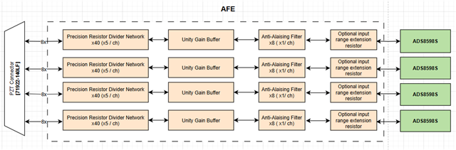

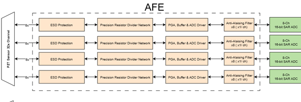

Attached is the basic architecture diagram for a more detailed understanding.

    In your 2nd image, with the AFE block diagram, is the ±50 V the input of the "Precision Resistor Divide Network" block? What would be the expected output range after that block?

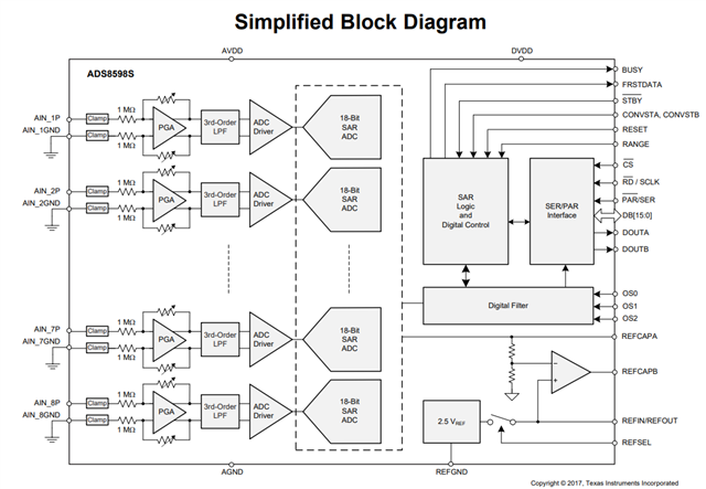

    The ADS8598S has an integrated PGA, LPF, and ADC driver with an input range of up to ±10V. If the output of the "Precision Resistor Divide Network" block is within that range then the ADS8598S would be able to replace half of the AFE block.

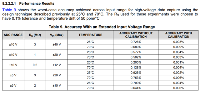

    The ADS8598S also has a constant input impedance that can be leveraged to further increase the input range beyond the ±10V, below is a table of the performance up to ±40V. Please see the Typical Applications section of the datasheet for more information as well as these reports:
    Circuit To Increase Input Range on an Integrated Analog Front End (AFE) SAR ADC
    Extending Input Voltage Range and Understanding Associated Errors for ADC With Integrated Front End
    Reducing effects of external RC filter circuit on gain and drift error for integrated analog front ends (AFEs): ±10V

    I have updated the interfacing block diagram as per the discussion, as shown below:
    Please let us know if any additional system calibration needs to be done for better performance.
    If yes, kindly provide the reference for the same.
    Thanks & Regards,
    Sahil Nayak
  • Hello Sahil,
    The additional calibration could be done with known system inputs, if a couple fixed values near the end ranges of the ADC can be set then that is all that is needed.  This would be more important if the optional range extension resistor is added, but it is good practice either way.
    Aside that, the block diagram looks good.
