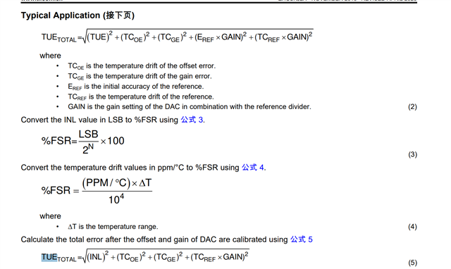

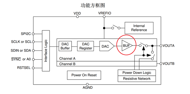

I see the TUE max value include Gain error right? this Gain error is DAC internal gain or Buffer gain?
How to understand this gain ? Thank you very much.

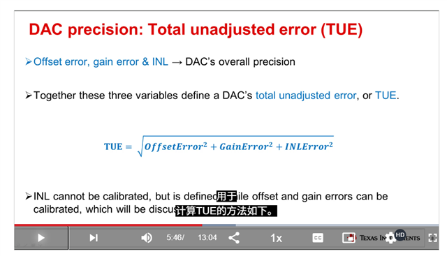

Why some DAC no TUE spec in datasheet?
How to understand TUE, in every output voltage , the TUE always small than TUE maximum?

    We try to characterize (measure) TUE in our newer high performance DACs. It takes time to characterize any spec to we choose what is most important when we release a new device.
    Gain error is the error in the slope of the transfer function. It's an error that can come from a few sources that results in a gain on the DAC output. Ususally the largest contributor to gain error is the output buffer stage.
    I'm seeing 0.1% maximum TUE in the DAC80502 datasheet. This means that at any code the output should be withing 0.1% of the idea value. The DAC8050x family is probably going to be the best choice here.
