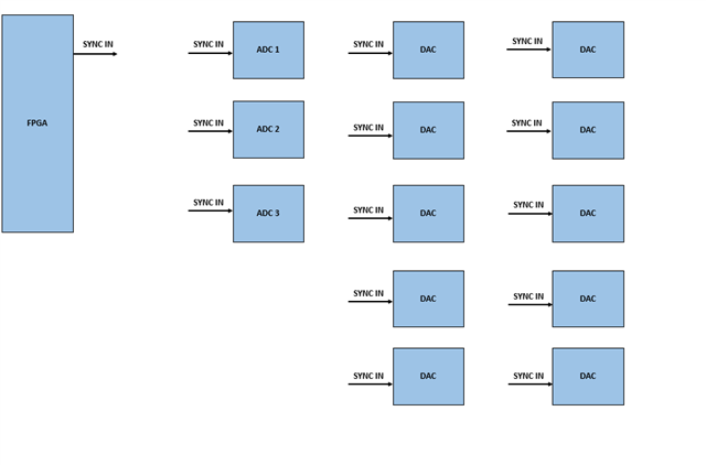

  • Hi Kang,
    My requirement is that all the ADC and DAC IC get an input signal from FPGA to have synchronization between all the DAC and ADCs in the board.
    In board I'm planning 3 ADCs and 10 DACs for my application.
    The SYNC IN signal is coming from the FPGA is fed to the ADCs and DACs as input signal.
    The signal from the FPGA may be a single SYNC IN signal for all the ADCs and DACs or  we use different sync signals like SYNC IN1, SYNC IN2,..... will be send to each of the ADCs and DACs IC. The function of the synchronization is this, the pin name can be SYNC in or LDAC etc. I want the signal coming from FPGA need to be communicated with ADCs and DACs in the board.
    This is the must requirement for DAC.
    Abhishek

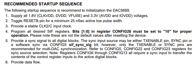

  • Hi Abhishek,
    The DAC5689 can support the sync function like above with limitation highlighted in the datasheet (snippet above). Please refer to datasheet for details.
    -Kang
