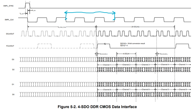

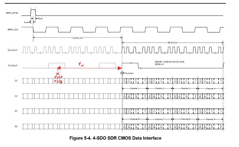

I am looking for the time tx between the sampling of the analog signals and the digital output of the sampled value of the ADS9817.
Currently, I am assuming that this time tx must be between 0 and t_{d_SYNC_FCLK}.
(The red X represents the moment when the analog signals of channels 1 and 8 are sampled)
Regarding the timing between the channels: Is my assumption correct, that channel 2 is sampled 12 DCLK cycles after channel 1, and so on?
