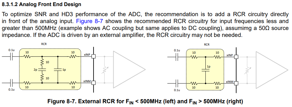

Hi team,
There are differences on analog front end design of ADC3549 in the datasheet of ADC3549 and in the design file of ADC3669EVM. Which one should my customer follow?
Datasheet of ADC3549
Design file of ADC3669EVM
Shunsuke Yamamoto
  • Hi Shunsuke,
    I would use what is shown on the EVM if the customer plans to use the ADC in a wideband application, 1GHz or more is required.
    If not, either of the two datasheet recommendations can be use or implemented.
    Rob
