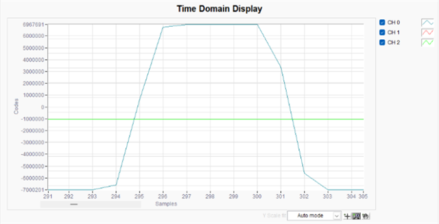

Q1. What kind of setting should I set when I want to achieve a rise time of 100us for step input? The rise time is the time when the digital output of the ADC is 10% => 90%.
Q2. How much is the accuracy worse for an ADC output rise of 20us?
I/O response tends to deteriorate if the OSR is increased in order to improve accuracy with the ADC, so I would like to confirm the trade-off relationship.
Example waveform: (top row: ADC input, bottom row: ADC output)
Hiromu

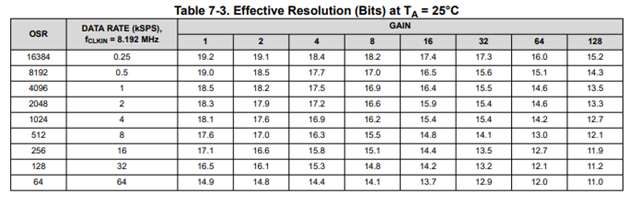

  • Hi Hiromu,
    Please refer to the below 2 tables to determine the settling times and ENOB based on the OSR setting.
    Thanks.
  • Hi Saleh,
    To achieve 100usec output rise time, can I simply calculate like this?:
    100usec < t_CLKIN x settling time(total)
    (*T_CLCIN = 1/8.192MHz)
    settling time(total) < 100usec x 8.192M = 819.2
    To achieve 10usec, settling time(total) must lower than 81.92. How can we achieve this? Use faster clock like f_CLKIN = 40.96MHz?

  • Hi Hiromu,
    For a step input to fully settle it with the max Fmod of 4.096MHz and OSR of 64 it would take 240 clock signals, which would be ~58.6us.  This is because it goes through a 3rd order sinc filter, you need 3 cycles for the step input to fully go through the filter.
    You would still see the output change in the 1st and 2nd captures, below is how a pulse being measured by the device would look.
