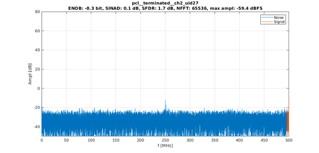

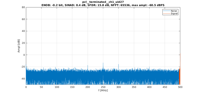

    Please try the following, turn off the analog input sig gen or disconnect it.
    Then capture an FFT plot and see if the noise floor goes down. Gets lower than the pervious plot you sent over, above.
    This will prove if the clocking signal chain you have is good enough for your application.
    If not, and your noise floor is roughly the same, then you may need to speak to someone at ADI on how to properly config the HMC7044 device to achieve better phase noise.
    Rob
  • Here are 3 FFTs: half-scale signal at input, terminated input with 50ohm load, floating input (ignore the filename string in the figure). I see a few dB drop in noise. Help me judge wether this is a significant drop in a noise floor level (please ignore the SINAD, ENOB etc. in terminated and floating input FFT figures) or not and issue may really lay in the clocking.

  • Hi Bartosz,
    To me, this looks to be your clocking setup.
    Can you change the external 25MHz clock/reference? Is says noisy, where is that coming from? A signal generator?
    If a sig gen, what is the model number?
    Rob
  • Hello Rob, thank you for the continuous engagement.
    Here's an updated, more detailed block diagram of our setup. It's actually a local TCXO: ECS-TXO-2520MV-250-AN-TR.
  • Hi Bartosz,
    I would update the ECS-TXO-2520MV-250-AN-TR device to a lower phase noise TXO.
    Notice the phase noise nor jitter is not listed in its datasheet.
    Rob
