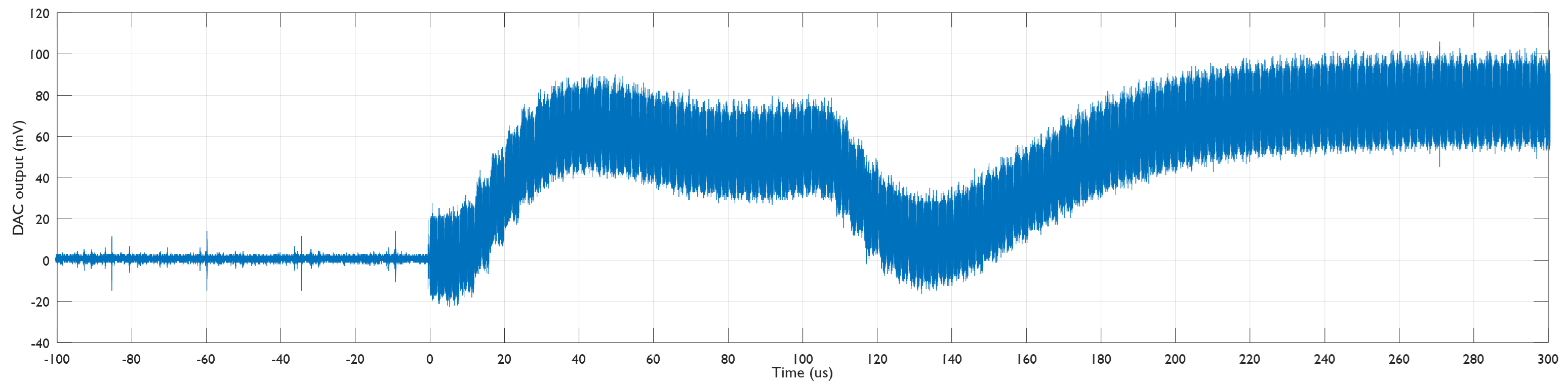

We are currently evaluating the DAC8562 using the DAC8562TEVM board. Here below is a capture with the oscilloscope of the DAC output. You would have noticed the large amount of digial glitches at the analog output. Is this expected or you suspect something's wrong in our setup?
Looking forward to your feedback, I wish you a nice day.

  • Hi Sergio,
    What is happening at the oscilloscope trigger time? Are you streaming data into the device? Is there significant clock feedthrough happening here? Really this looks like a noise, oscilliation, or scope problem.  This behavior is not expected of this device.
    Are you using the on-board reference? Is the EVM well grounded with the supply and the scope?

    We solved the problem by adding SMA connectors to capture the two DAC outputs in a clean way.
    As you can see here below, we used the AGND from TP4 and the outputs are routed without crossing other signals.
    I suggest you also add them to the design.
    We would have missed the best glitch-spec DAC if it wasn't for that.
