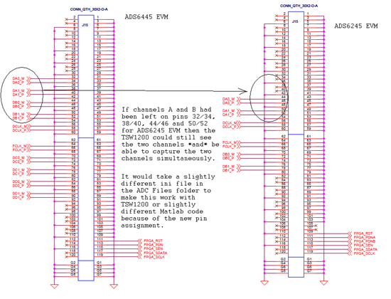

  • Great explanation!  I will try this and see how it works.  For now I could live with halfing the data rate. In the future, we plan to design a custom board for the ADS6245.  The TSW1200 will initially still be used to collect the data.  From my interpretation of your remarks, we could connect the "channels B and C" outputs from the ADC to the connector pins for lane 1 and lane 2 into the TSW1200 and regain the full data rate capability of the TSW1200.  Please confirm that I have interpreted your explanation correctly. Thank you for your prompt assistance!
    Yes, i think you understand it correctly.  And if you did respin the ADS6245 board and moved the channel pin assignments properly, then the TSW1200 could still be fully functional with the new board (with a new ini file in the ADC Files folder, but with a slight edit at the bottom of that in ifile) *and* the Matlab code could use the hardware for a simultaneous capture from the 2 channels.  I've gone to the schematics for the ADS6445 and for the ADS6245 EVMs and illustrated how the new connector pin assignment could have been done.  DCLK adn FCLK must be left in position and not messed with, though.
