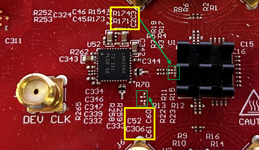

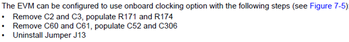

I'd like to change from external to onboard clock for ADC12DJ5200RFEVM.
Q1
Regarding C2, C3, R171, and R174, they are marked on the silk screen. Are these the locations indicated by the green boxes?

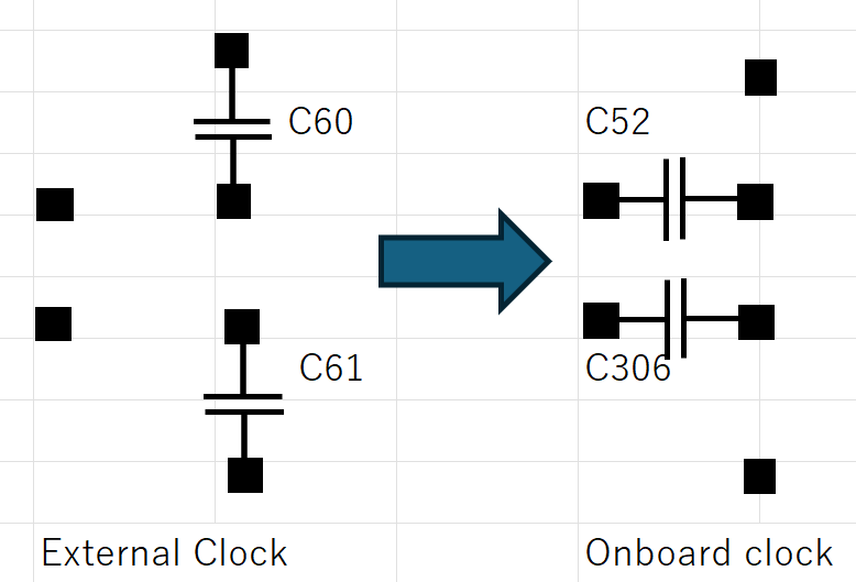

Q2
Are C60, C61, C52, and C306 also the locations indicated by the green boxes? Also, is my interpretation of the diagram correct?
