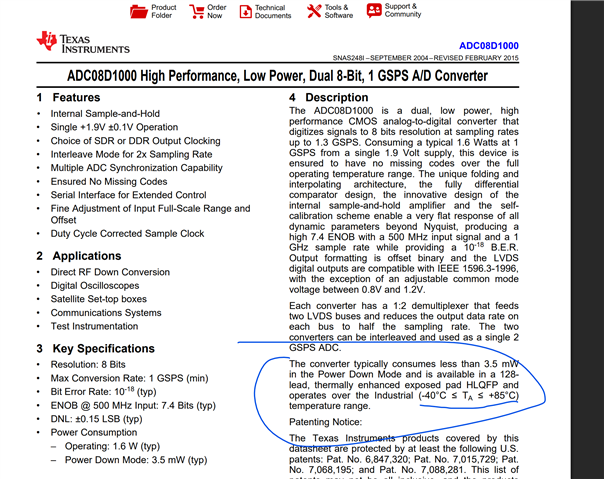

  • Hi Ryu,
    #1: please see the following attached article for epad recommendations, see pages 1-3.
    6661.AN-1142-HSLayout.pdf
    #2: please see the pic below for the ADCs operational rating as shown in the datasheet.
    Rob
