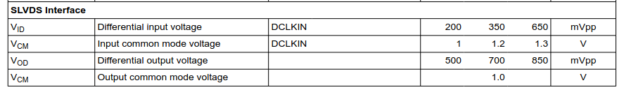

We are designing our hardware to interface ADC3663.
In this I am taking ADC3663 and TSWDC155EVM as references.

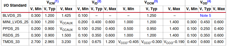

TSWDC155EVM, the LVDS lines are from a bank with VCCO25. Here I presume, IO standard used is LVDS25.
But as per FPGA IO spec, for BLVDS25 stadard VICM is 1.2V.
As per ADC3663, as per below table from DS, VCM is 1V
Can you please clarify this difference?
