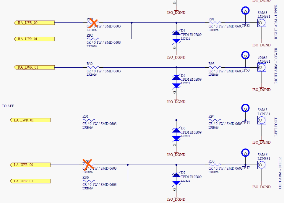

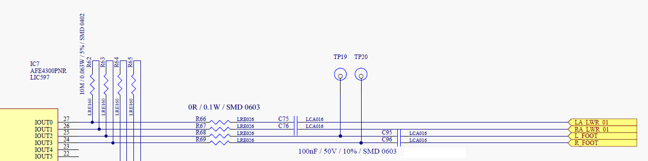

We are analysing failures of the AFE4300 in a clients product. There have now been 15 boards with the damaged AFE, these boards have been installed in health stations for several months before failure. It appears the IOUT0 pin is being damaged and the IOUT1 pin is outputting a reduced amplitude signal. The AFE4300 is only being used for the body composition measurement functionality.
Below are the scope captures for 3 different scenarios. 1. Working AFE, 2. Health application reading low values, 3. Health application reading near zero values. We are seeing approximately 50% failure with low values and 50% with near zero values.

Below are schematics relating to the output. The inputs are buffered by opamps before going to the AFE. ISO_GND is isolated from the main supply using NXE2S1205MC-R7 and digital isolators for the signals.
I would greatly appreciate some assistance in understanding the cause of the damage to AFEs and how we can resolve this.
