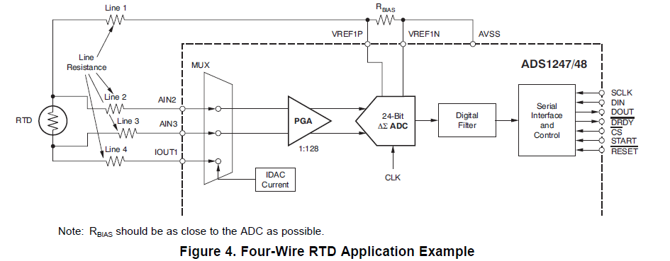

  I'd like to know how the ADS1147 / 48 input impedance changes when the Idac is ON: in this case there is a "current surce" connected to the input pin thus the impedance should be a little bit lower; I'd like to have a numerical value.

  • Hello Luis,
      what I mean is that when we are connecting the current source we have a mosfet drain (I suppose) in parallel with the PGA input (mosfet gate) thus I expect that the input impedance will be a little bit lower due to the non infinite impedance of the current source. The input impedance of the PGA is very high thus even if the current source output impedance is high, it will decrease the total impedance.
    Is it correct?
    Gabriele
  • Hello Gabriele,
    - An ideal current source will have an infinite output impedance.  As you have mention, a real current source will have a finite but relatively high impedance in the order of MegaOhms.  A high output resistance in the current source is desirable; since this reduces the dependency of the output current to the output voltage; where the output current will change slightly as the output voltage present changes.  In the typical ADS1147/8 application, the IDAC excitation current will source current to a RTD or a thermistor sensor.  In the recommended configuration (shown below); the ADS1148/7 device is set up performing a ratiometric measurement, where the IDAC current is used to excite the sensor and also to produce the reference voltage across the RBIAS resistor.  In this ratiometric configuration, the errors due to the absolute value of the IDAC and the IDAC current drift are eliminated, since the changes of the IDAC current are reflected both at the input path and the reference path. The RBIAS resistor generating the voltage reference must be a precision low drift resistor.
    - The amplifier measuring the sensor is required to have high input impedance. The output impedance of the sensor being measured could potentially interact with the input impedance of the instrumentation amplifier and produce an attenuation or gain error.  Also, a low impedance amplifier would have a loading effect in the circuit that could cause errors in the measurement.  When performing measurements using the ADS1147/8, the input voltage measurement is made using the internal Programmable Gain Amplifier (PGA) of the device.  The internal PGA is optimal and provides high impedance and low input bias currents.
    In the 4-wire RTD  configuration below, the excitation current path is independent of the sense path; and since the internal PGA has high input impedance and low input bias current; the errors due to the series resistance in the signal path are negligible.
    In the 3-wire configuration, the designer has to ensure that the impedance/resistance through the AINP and AINN signal paths are closely matched, since the excitation current flows through to them.  The (2) IDAC currents are closely matched on the device, however, in applications that require higher accuracy, the user could perform the procedure attached to calibrate for the IDAC current mismatch.  The 3-wire configuration is also ratiometric, where the absolute value of the IDAC is not critical.

    Since the output impedance of the current source relates only to the absolute value of the current source, and since the configuration below is ratiometric, the output impedance of the current source does not contribute any significant error in the RTD/sensor measurement.
