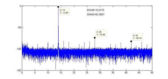

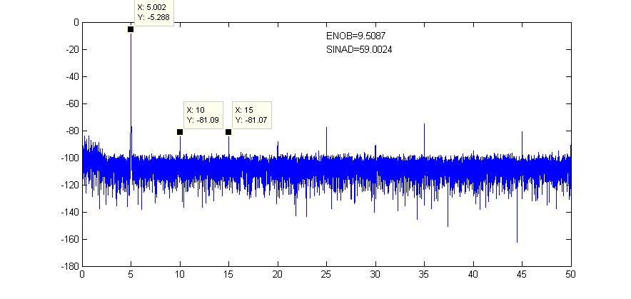

I'm doing a work with ADS62C17, I got a spectrum like this. the noise floor seem be OK, but at the low frequency region nearby DC to 2.5MHZ, there is a noise rise about 10dB. does anyone know what wrong is?
I got a differential amp before the ADC, that is ADI's ADA4930.

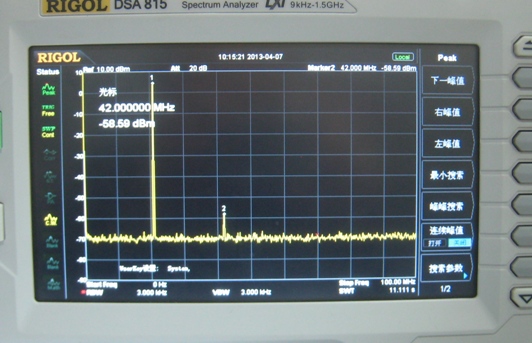

    First, I post my signal generator spectrum, since its specs is relavant with measurement result:
    5MHZ:
    14MHZ:
    44MHZ:
    you can see the performance is not so good, but it is my only.

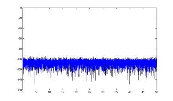

    Secondly, I post the spectrum without input signal:

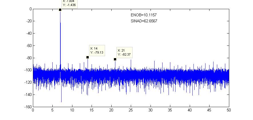

     then, 5 MHZ signal with input level 2Vpp, 1.4Vpp and 1Vpp:

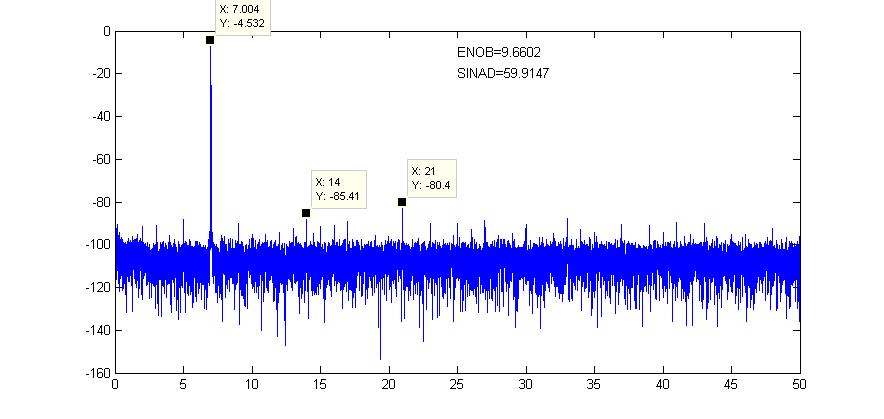

    then 7 MHZ input, 2Vpp, 1.4Vpp and 1Vpp:

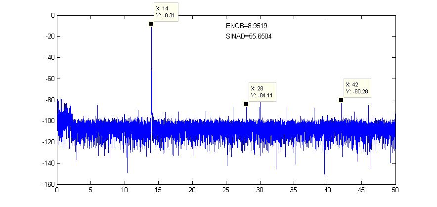

    then 14MHZ, 2Vpp, 1.4Vpp and 1Vpp:

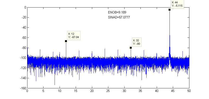

    then 44MHZ:

  • Hi Donald,
    There doesn't appear to be any logical pattern for the noise. For instance, if it was related to the analog input level, you would expect the noise to be largest when the input signal is at full scale. Instead, we see that sometimes the noise is largest at full scale input and other times it's larger when the signal is backed off.
    Is the noise always present or does it vary from capture to capture? Have you made any other progress?
