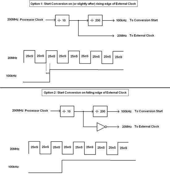

    See bitmap attached.
    In our application we will be running at a sample rate of 100kHz, and
    interfacing to the ADS8555 using a 16-bit parallel bus. We are using
    software mode. Everything is working well so far.
    We are currently operating the ADS8555 using it's built-in internal
    conversion clock, but to eliminate clock/sample jitter and to maximize
    overall system throughput, we would like to operate the ADS8555 using an
    external clock, running at 20MHz.
    The microprocessor processor we are using gives us basically two options for
    driving both the External clock and the Start Conversion signal. See the
    diagram attached.

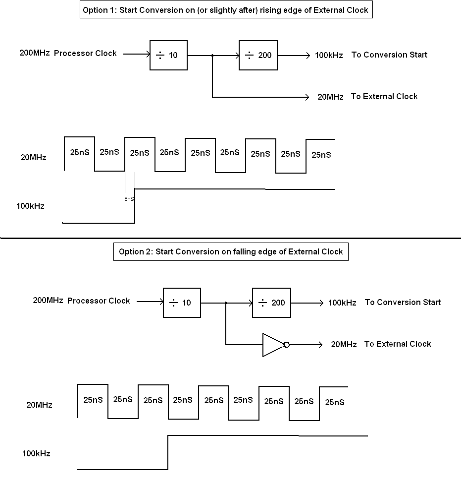

    In both cases, we start with the 200MHz processor clock and divide it down
    to 20MHz. In the case of "Option 1" our "Start Conversion" signal happens
    almost coincident with the rising edge of the External Clock (around 6nS
    delay).
    In the case of "Option 2", our "Start Conversion" signal happens exactly
    coincident with the falling edge of the External Clock.
    (In fact, there is a third option where we can remove the 6nS delay and have
    the "Start Conversion" exactly coincident with the rising edge of the
    External Clock.)

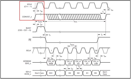

  • Hi Marc,
    The datasheet does highlight a timing requirement with respect to CONVST and XCLK. See page 10 of the datasheet, timing specification tS3. The specification describes a required setup time for the rising edge of CONVST to a rising or falling XCLK edge as 6ns.
    Looks to me like option 1 is the way to go. Officially I'm "The DAC Guy" though, so I'll see if someone from one of the ADC teams will also give this a look in case they have any extra information.
  • Kevin,
    Thank you for the information and for your help. Yes, we saw page 10, but this is listed under Serial connection. The similar timing for the Parallel connection does not even mention this relationship, which is why we thought we would ask and confirm.
    In any event, unless someone comes along and contradicts your observation, we will indeed use the Option 1. We have updated the timing diagram to further clarify the relationship as it pertains to our situation.
    Marc

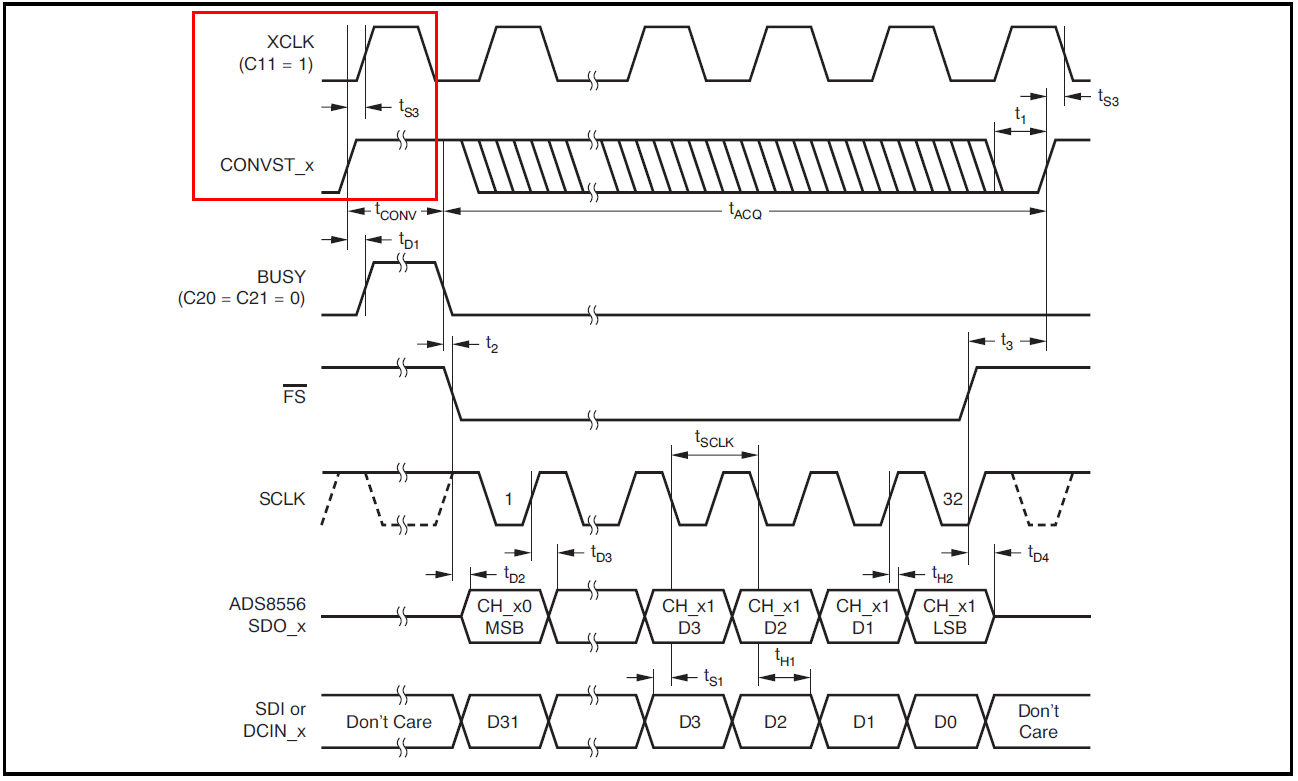

  • Hi Mark,
    The sample and hold switches close with the rising edge of CONVST, so that sets the instance of sampling - the conversion starts with the rising XCLK relative to CONVST with the 6ns hold time.  If you are toggling CONVST synchronous to the falling XCLK edge, the conversion will always start with the next rising XCLK assuming you have at least the 6ns setup time, this is true for either serial or parallel operation.

    Thanks for the information. What you wrote makes sense. However, we'd like to
    confirm one more thing and I appreciate your patience with all of the questions.
    On page 10 of the datasheet, it indicates that there is a 6nS setup time with
    respect to either the rising or falling edge of the external clock, but somehow
    intuitively that does not make sense, and it also does not jive with what you
    wrote above.
    If indeed the setup time is only with respect to the rising edge of the external
    clock, then perhaps in our case it would be best to use the falling edge of the
    clock synchronous with the rise of Conversion Start, which would give us a full
    25nS of setup time.
    Please confirm our understanding...

  • Hi Marc,
    Sorry for the delay here - I actually went back through the data sheet and realized that the ADS8555 has a slightly different conversion mechanism than what I described last week.  Take a look at page 19, under the CONVST_X description.  The tS3 time is against both the rising and falling SCLK edge because either edge will trigger the start of the actual conversion.  You could sync your CONVSTs with either the rising or falling clock edge and the conversion will start with the next edge.
