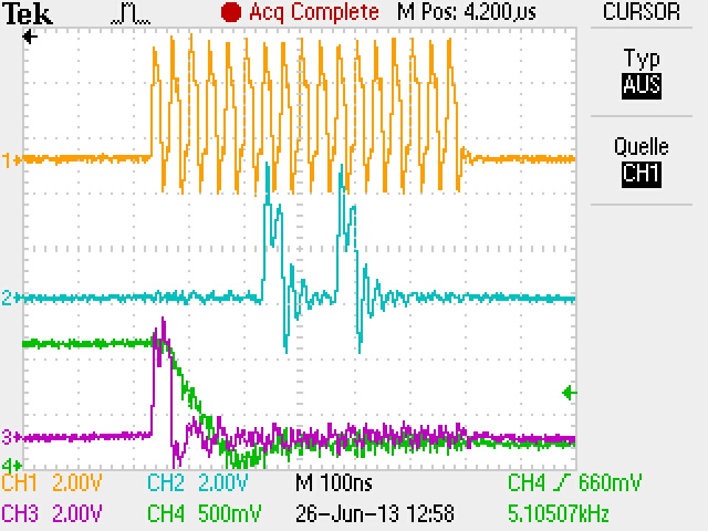

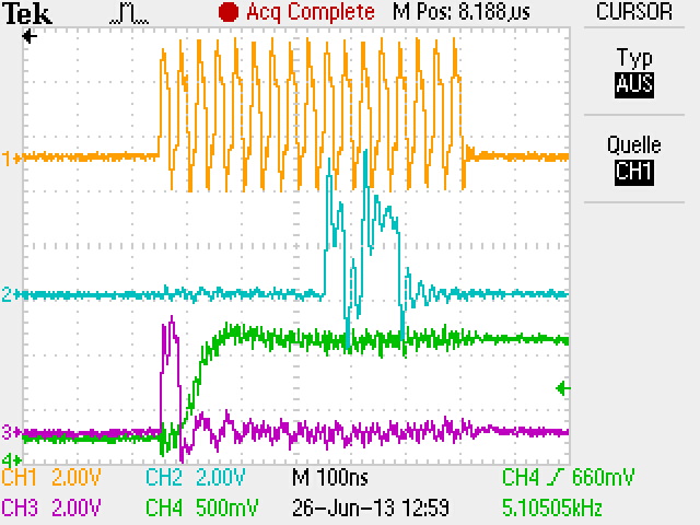

The following screenshots show two spi communications, directly following after each other and the behaviour of the output. That channel mapping is as:
CH1: SCLK
CH2: DIN
CH3: FS
CH4: DAC OUTA
The first screenshot shows the spi command 0x0440, which should immediately update the output voltage to~1,08V. But this can be observed as recently as the next spi command is send (see second screenshot). But at this moment, the command 0x00B0 is transmitted, which should then update the DAC to ~0,17V.

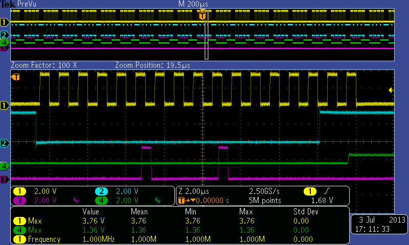

    In the below oscilloscope captures,
    Trace 1 (yellow) – SCLK
    Trace 2 (blue) – FS
    Trace 3 (purple) – MOSI
    Trace 4 (green) – DACA OUT
    Figure 1 – DACA output updates after 17th rising SCLK edge
    Figure 2 – DACA output updates due to rising edge of SCLK returning to high idle state after 16 pulses
