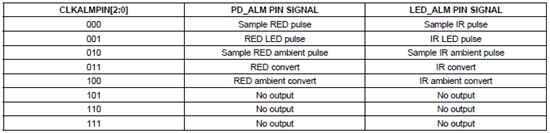

1. I have found a part of datasheet which probably contains an error (or it is not clearly written). It is related to Table 5. on page 60 (SBAS602D - MAY 2013).
1a. What is the difference between "000" and "010" setting? The last column has one word "pulse" in addition but what does it mean?
1b. What is the function of the "100" setting. Does it means - " LED1/2 Ambient SAMPLE clock " or " LED1/2 Ambient CONVERSION clock ".

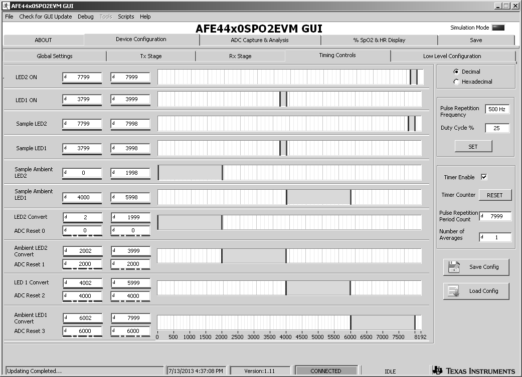

8. And one "application specific" question. All examples on the demo board and in the data sheet, are designed to use relatively "long" LED ON pulses and relatively low Led current. But I thing in some applications it will be better to use shorter LED ON pulses (for example 100us or even 50us)  and higher currents (up to 200mA). This will reduce the impact of the ambient light noise. Right?
On page 23 is written that the minimum supported sample time is 50uS. Can I use 50uS LED ON and LED SAMPLE times in this case? If this is true, can I use longer conversion times (with a lot of averages), even of lower sampling time? For example can I work with the following timing settings:
PRF = 500Hz (PRT = 2ms), LED1/2 ON time = 50us, LED1/2 sample time = 50us, LED1/2 ambient sample time = 500us, All ADC convertions time = 500us, Averaging = 10.
See next picture:

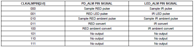

    1. Below is the correct Table 5 - PD_ALM and LED_ALM Pin Settings.

    8. The timing settings you have mentioned is possible. Set averaging to 9 instead of 10.

    8. You can work with longer conversion times and smaller sampling times. I have checked with your timing settings as well.
