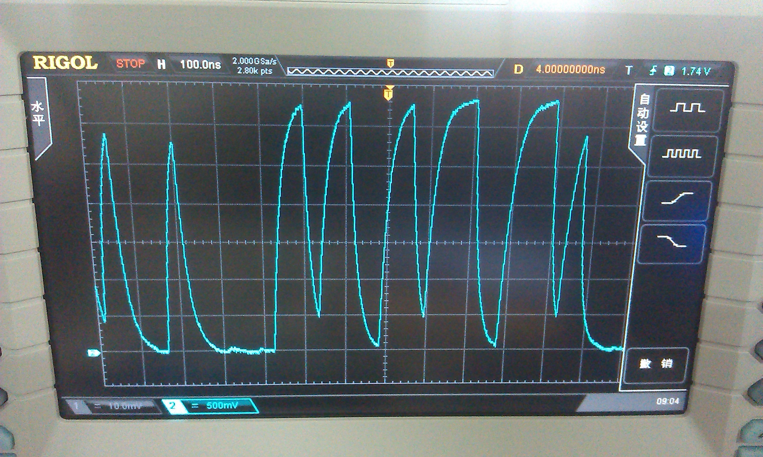

  • Please make oscilloscope captures on both sides of R111.
    Remove R111 and make a third capture of the direct output of the TVP

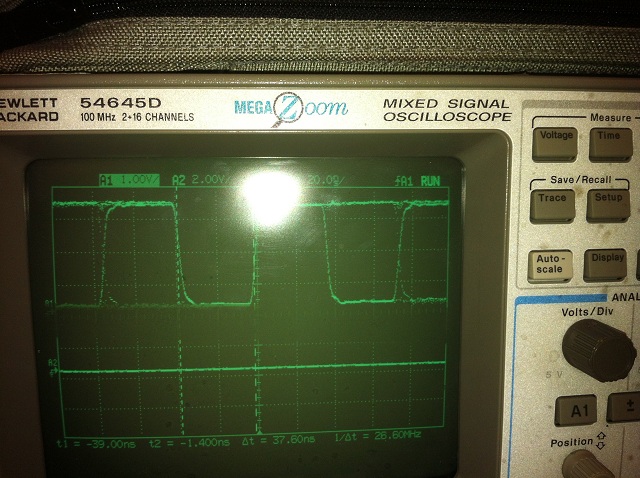

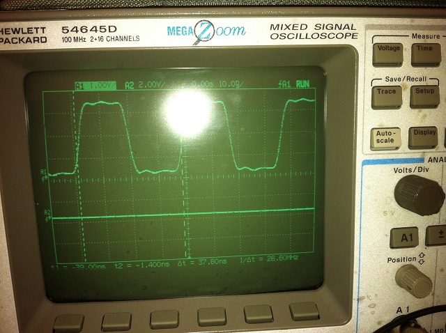

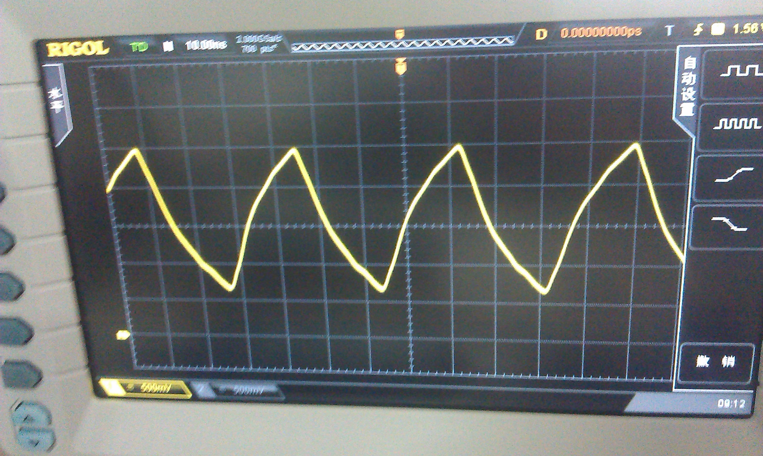

  • The oscilloscope of our team is broken down and today i borrow another one. The pictures are the information for SCLK and data pins before and after removing the R111.Thank you
    Best Regards
    XiaoQi
    sclk_behind_R111
    sclk_front_R111
    data
    Sclk_remove_R111
    PAL_signal
  • Either your power supplies are bad or you have something loading the outputs.
    Make sure that the oscilloscope impedance is NOT set to 50R.
    Check all your power supplies at the TVP pins when video is active.
    Clock should look like this...
    Data should look like this...
    These were taken on the EVM with a load on the output so with no load they would look even better.

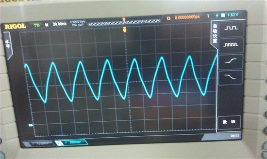

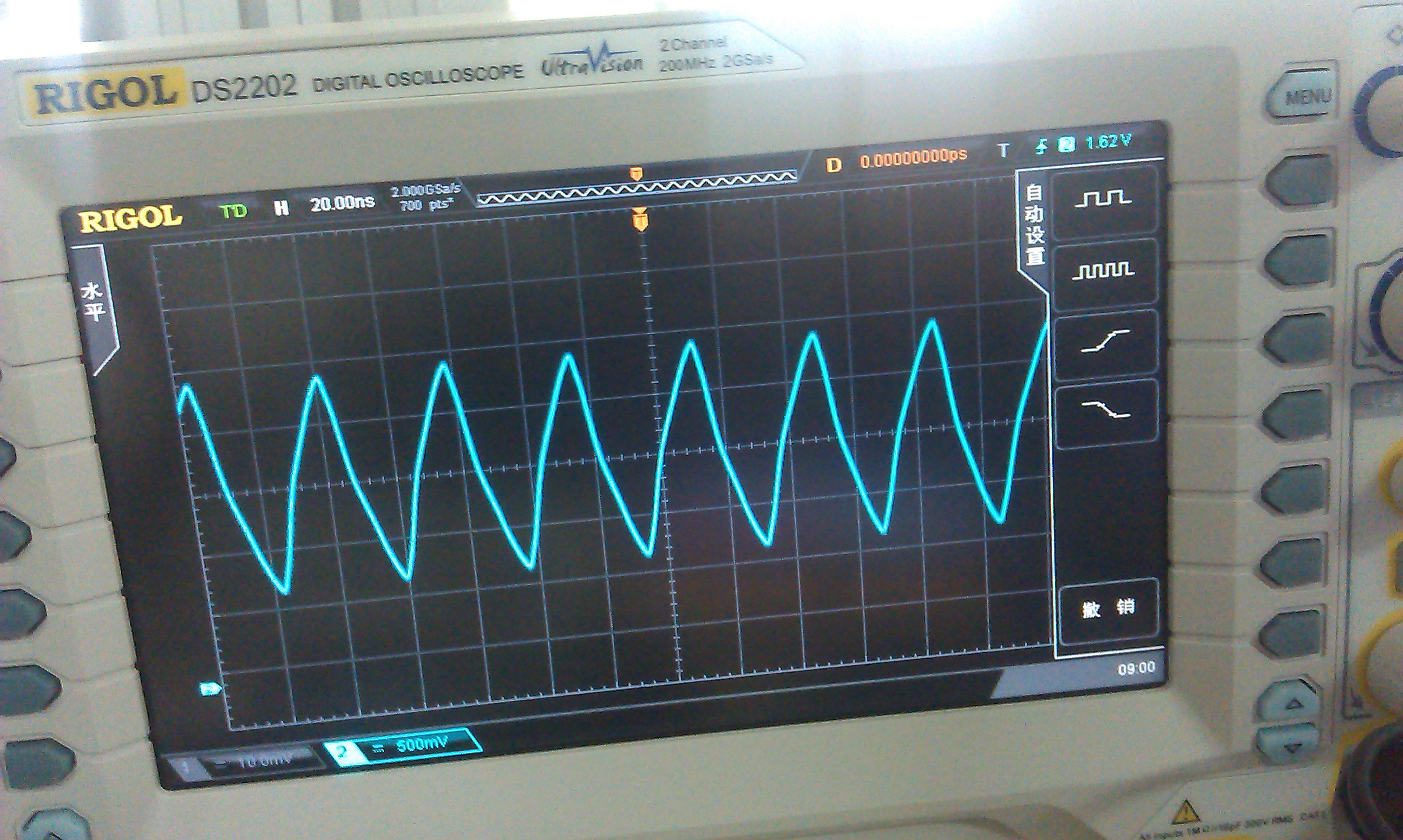

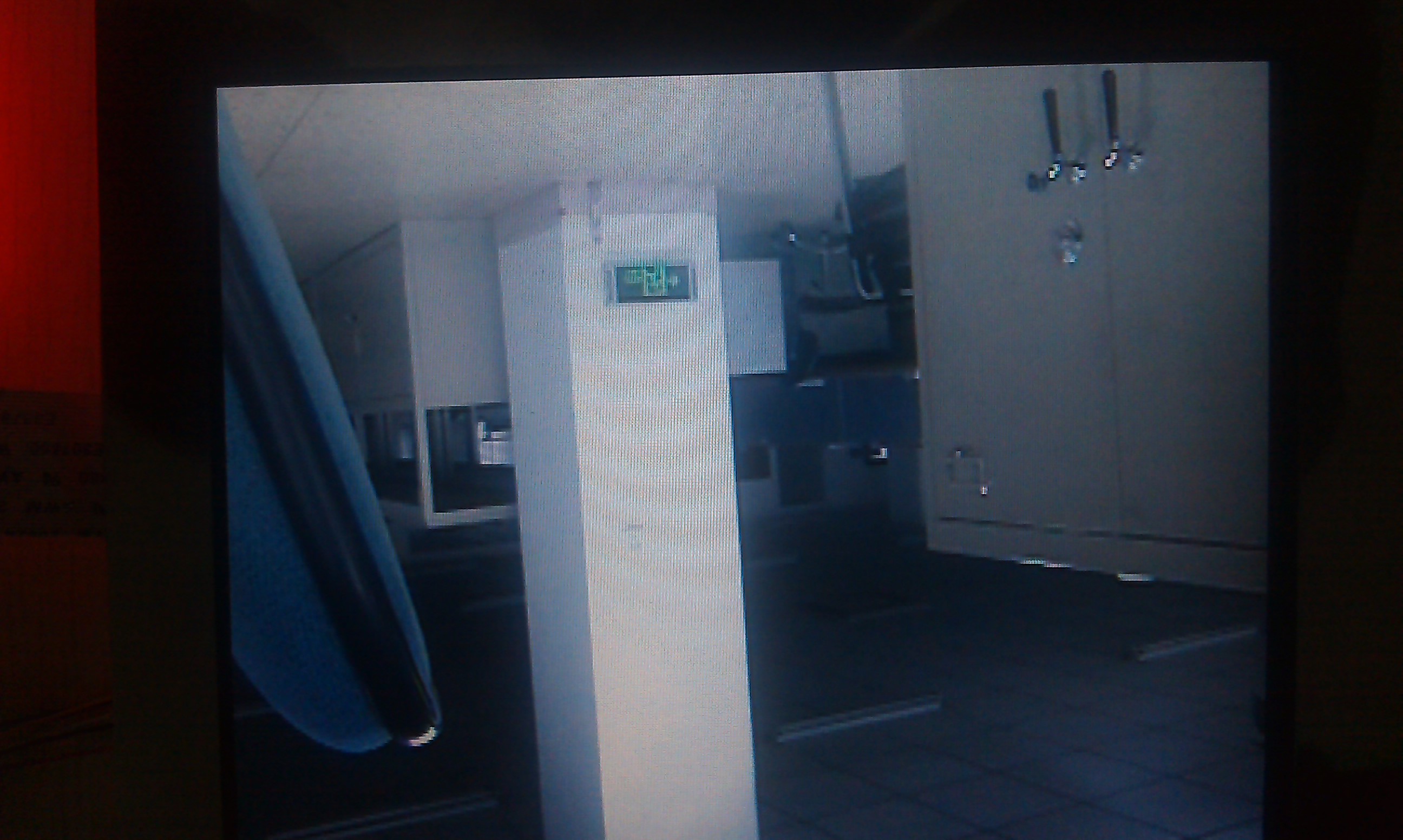

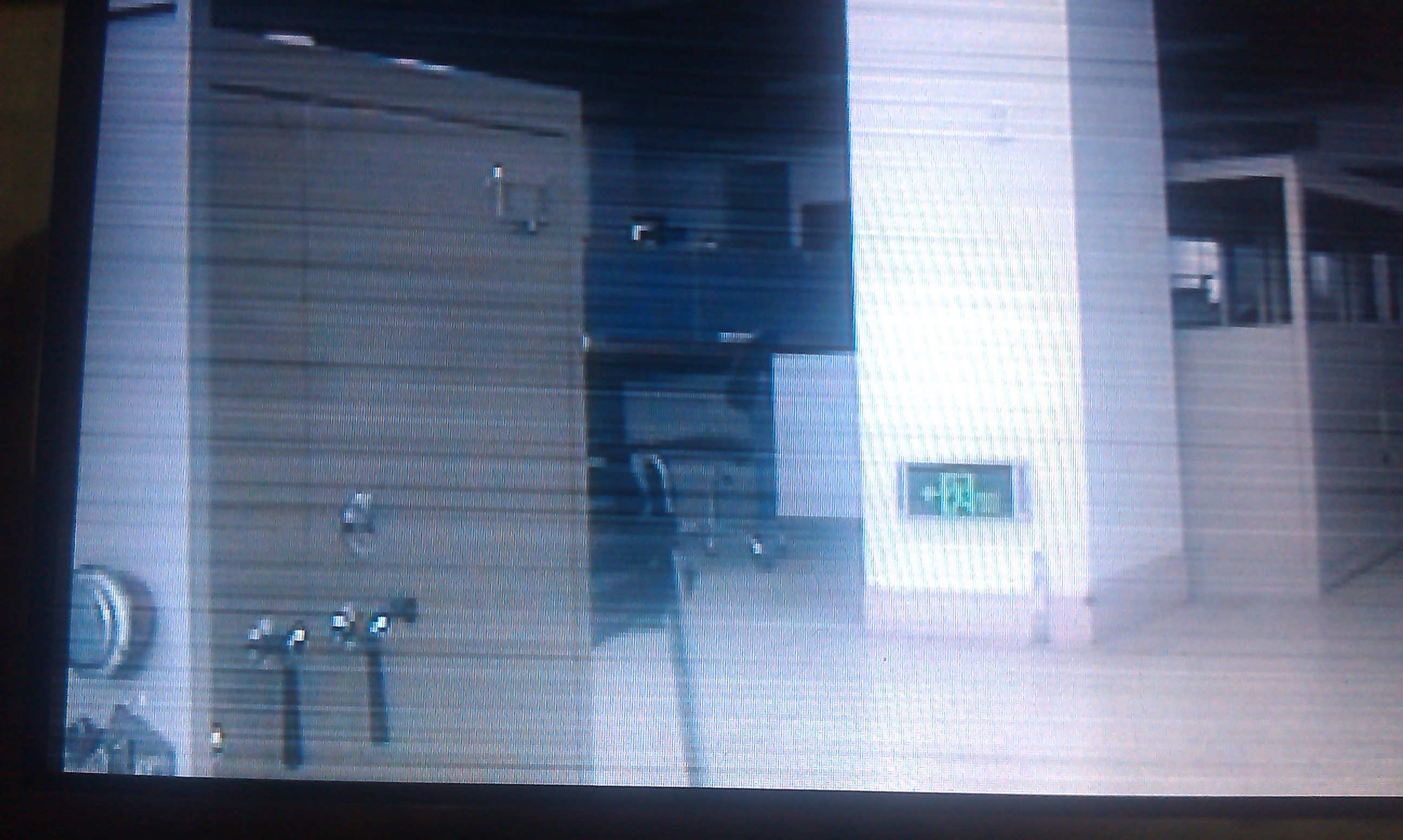

  • Steve:

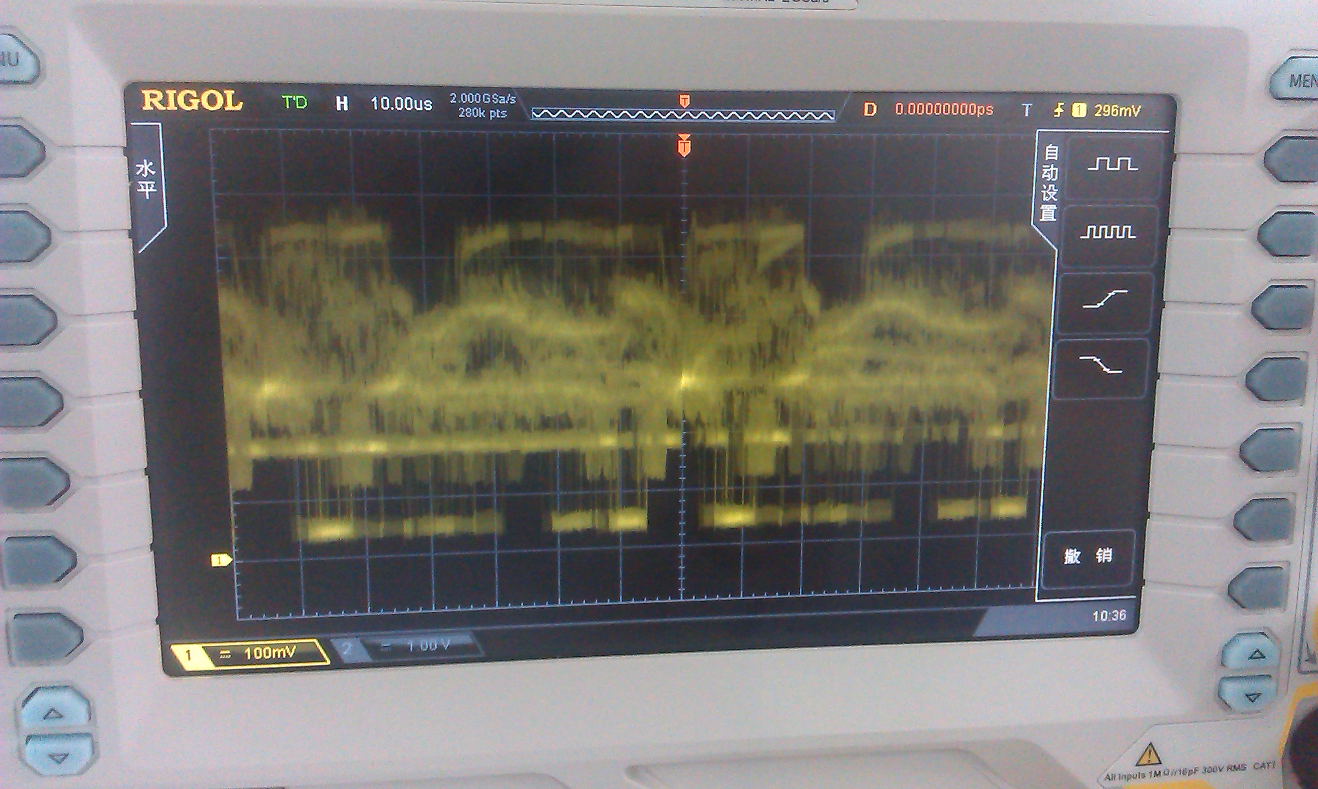

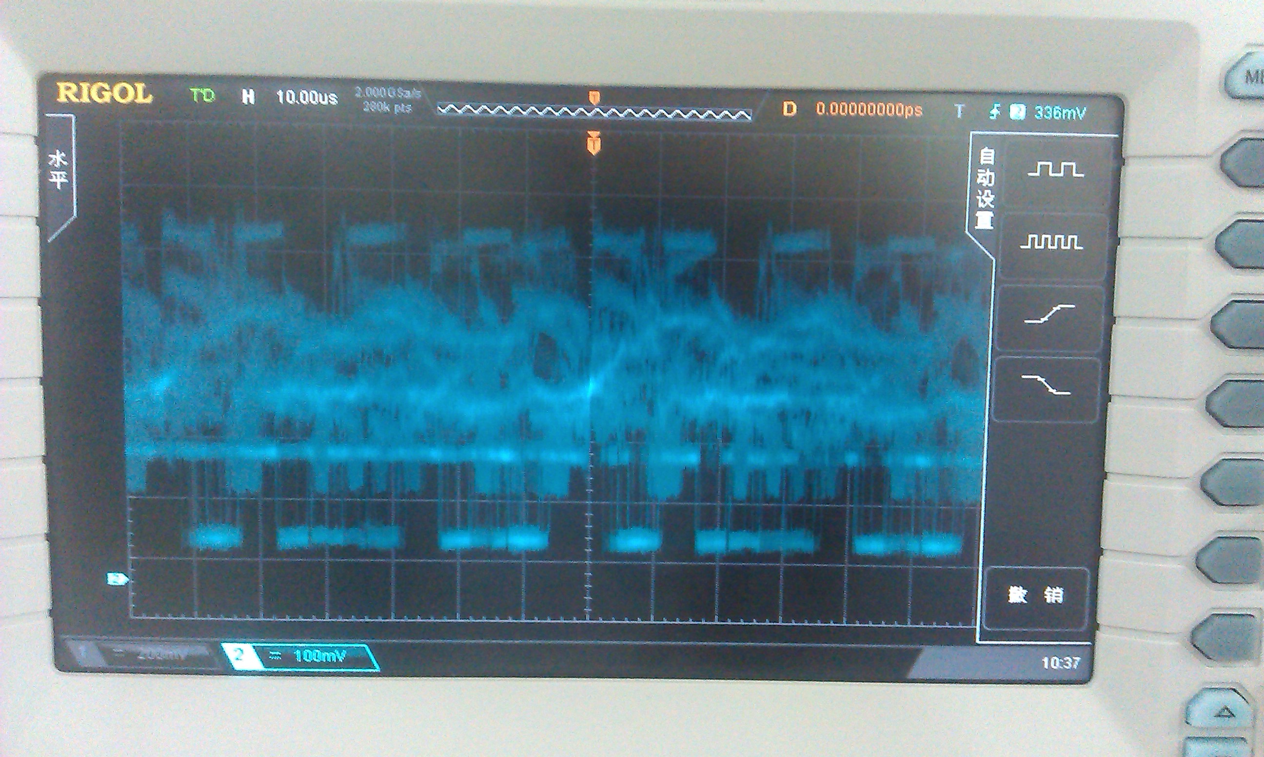

    I have checked the circuit concerned with the TVP5151 and it seemed to be all correct. One colleague told me it may be a problem on hardware. The signal on the line is interfered by others, but he checked the circuit for a whole day and he still didnot find the interference souce. This is the signal of good and bad  and the input video signal.
    BG,
    XiaoQi
     The good image
    The bad image
    The good video input signal
    The bad video input signal
  • Move the scope trigger point down so that it only catches the low going sync tip hence will display a stable line image. This will make the scope captures much easier to see.
    As a test try swapping the good and bad inputs to the TVP. This can be achieved by lifting the TVP input coupling capacitors and re-soldering them in an upright orientation, then bridge a wire from the now floating top of the capacitor to the alternate TVP input capacitor pad. This will help determine if the root cause is before or after the input coupling capacitor.
    BR,
    Steve

  • If the 'good' channel is good with one input but bad with another input then the input part of the circuit is bad, not the TVP.
    Did you lift the input coupling capacitors when you did this experiment or did you simply connect wires?
    Please re-send the original oscilloscope captures but with correct triggering so we can see a clear video signal.
    Please also measure the power supply noise. If you suspect the power, then check it :)
