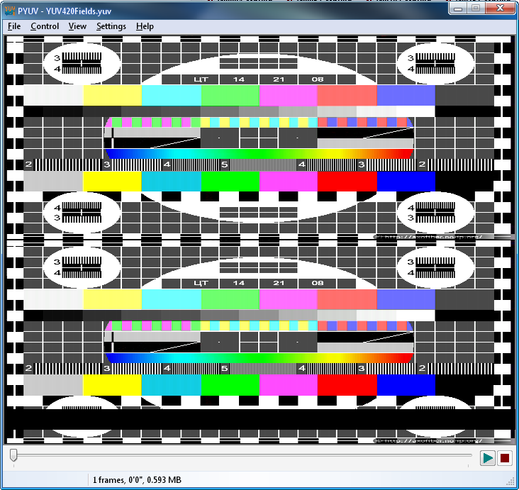

  • Time passed... More time passed... Even more time passed... Hello there! :-)
    With your help we've got it working so that the original problem with 4 channel video has gone away. Thanks Steve!
    For a while we've been analyzed captured video streams. We found out that each channel has a cluster of some 8 or 12 (doesn't matter actually) empty (dark) scanlines, appearing only in the second PAL video field, beginning at an arbitrary AV line number. We've never seen it in the first field. The user's manual says that one can observe empty lines allright.
    The question is now if these dark lines might be fought over by e.g. using a modified patch code?

  • Andrew,
    The is no way to eliminate the blank lines. These blank lines are inserted in order to compensate for the fact that each analog video stream that is being decoded is completely asynchronous to the other analog video inputs but the digital outputs are synchronous.
    You will find that all channels except the primary channel will have blank lines and/or 'missing' blanking lines in order to compensate.

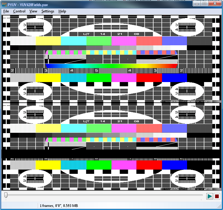

  • Dear Steve,
    I'm Sergej, we are all from one project who left here posts.
    The short description of problem is on images I attached. These are 2 images of second fields from 2 frames sampled in different time Please look at them and compare - you will see black horizontal bar which appears on each second field of each frame and it goes from bottom up. Each such black bar contains 8 strings. We cannot find the reason by which these 8 strings disappear on each second field in each frame on all 4x channels. The format is PAL 720x576. Now it is the most seriuos problem we have in our device. Please help to solve it.
    Thank you!
    Looking forward your answer!
    Sergej.

  • Sorry for the delay in responding but I have been out of the office.
    I don't know enough about the OMAP device but I think the issue is there. The OMAP device will receive a continuous stream of data that needs to be processed in order to extract the active video lines and to which channel they belong.
    My feeling is that the OMAP device hardware and/or software are assuming certain blanking periods and skipping video data for these lines.

  • I am not sure what I am to answer?
    The TVP will not blank out active video lines.
    Without verification with a logic analyzer of the data stream content I can't comment any further.
    This appears to be a processor side issue.
