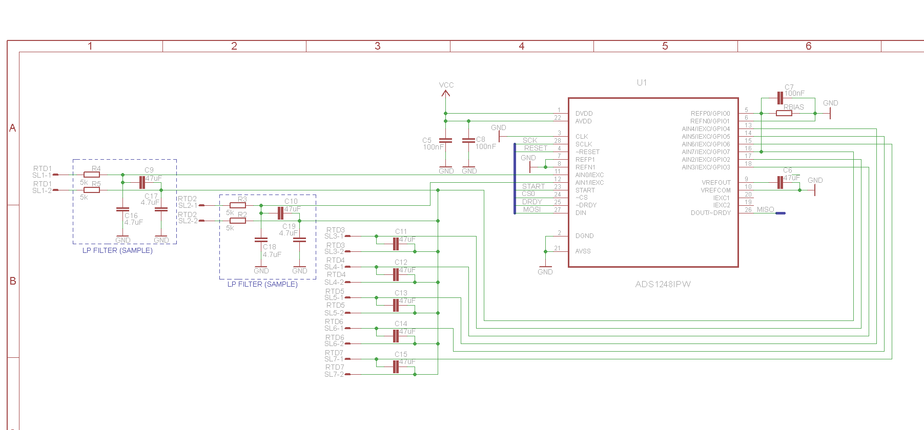

    I designed the first version of the scheme with ads1248. This circuit works with 7 RTDs (Pt1000) in 2-wire conection. AIN7 is the common pin. Device will be supplied by 3,6V battery (it does not matter now). Two input LowPass filters are in scheme only for example. SL1 - SL7 are connectors for RTDs.
    Could someone with more experience check this circuit please (like blocking capacitors, etc.)? Is it necessary to use a LowPass filter on pins REFP0 - REFN0?
    Thank you for all comments!
    VojK

    In general, your schematic looks ok. There are 7 two-wire ratiometric measurements possible with RBIAS for REF0. The input capacitances used at AIN1 (both the common-mode and differential) look large to me. You can compare those values to the ones used in the ADS1248EVM.
    Note that you only need to have one capacitor off of AIN7. For example C17 and C19 are duplicates AINN differential capacitor of the LP filter (you don't want 7x capacitors on the AINN node).
    THe REFOUT capacitor is 47uF which is ok, but remember that this will take some settling time at turn-on. This is described on page 29 of the datasheet. Filtering on REF0 can be used if desired.
    If you are in need of further information, there are many good descriptions and examples in application note sbaa201 in the website below:
    http://www.ti.com/lit/an/sbaa201/sbaa201.pdf
    There is also a reference design writeup that includes RTDs and the ADS1247 at the following site:
    http://www.ti.com/lit/ug/slau520a/slau520a.pdf
