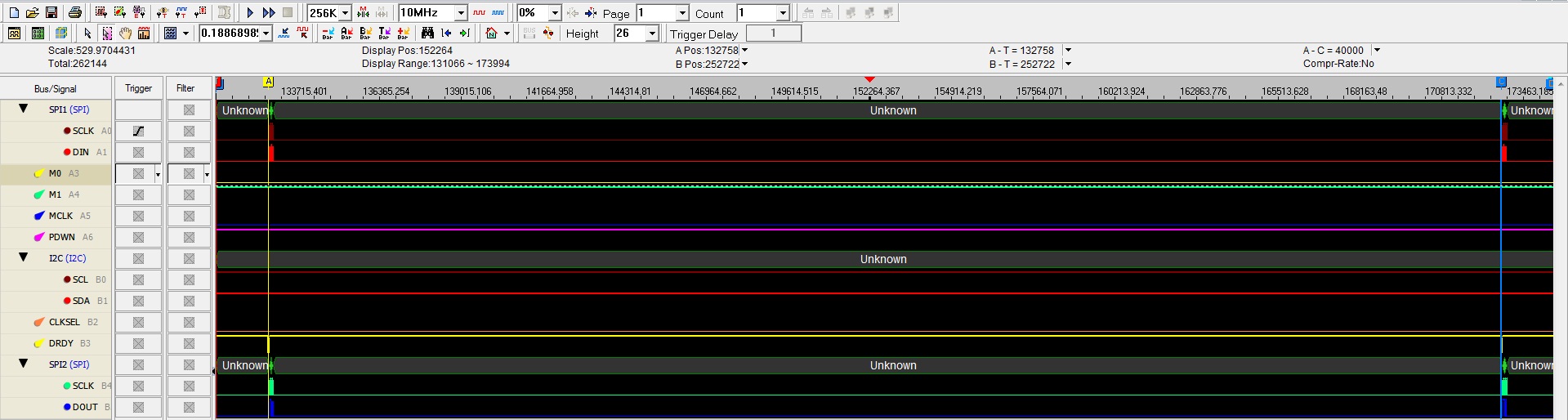

Print screen for logic data of ADS1282EVM-PDK reading data in continuous mode:
At this moment I can’t read the data DOUT at same time (using a LV4052 MUX), but even sending SCLK transitions IC per IC to read the data, should the DRDY output goes low at same time after next conversion?
In the ADS1282 datasheet pag.:27 says: “When reading data by the continuous mode, the data must be read within four CLK periods before DRDY goes low again or the data are overwritten with new conversion data”. It means I need to read all 32 data bits 4 CLK periods before DRDY goes low again, in my case 250SPS I have approximately 4ms to read the data, so even using a LV4052 MUX to read the data IC per IC, I still have enough time because my SCLK frequency is around 2MHz?
DRDY resets high on the first falling edge of SCLK, in my case the SCLK signal is MUX so DRDY for the last IC will take longer to reset high, even doing in this way I still have the conversion for all IC’s synchronized and the DRDY output goes low at same time after next conversion?

    Yes! Page 43 of the ADS1282 data sheet shows that only a single /DRDY signal is needed if all devices are synchronized.
    /DRDY indicates when a conversion is complete. If all four channels are synchronized, they will start and end conversion cycles at the same time!
    Yes, you should have plenty of time to clock out all the data for 4x channels at that data rate!
    This is not a problem! The /DRDY's will not return high at the same time, but the ADCs will still be continuously converting and will remain synchronized.
