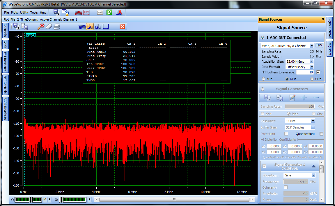

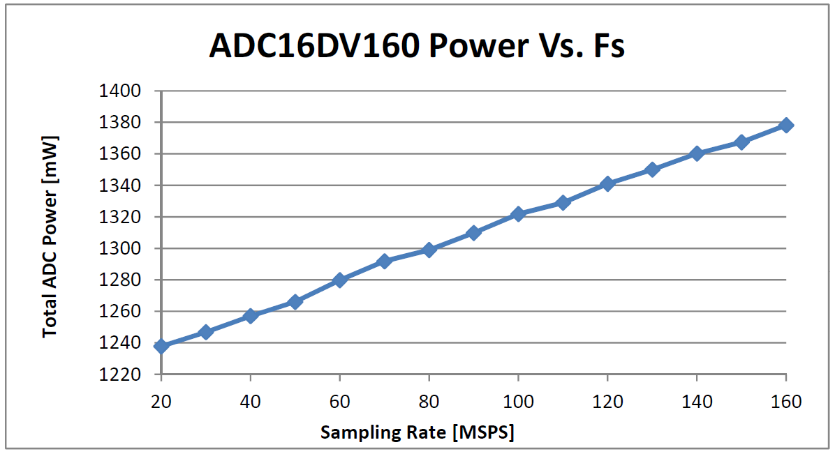

we want to compare the performance of ADC16DV160 vs AD9653. Where can we get the following datas for ADC16DV160?
1.) SNR for fin@9.7MHz?
2.) Power(per channel) @ 25Msps?

Dear Josh
The value you mention for SNR @fin=9.7MHz and 1-dBFS with -78-dBFS is at the max sampling freqeuency 160MHz of the device.
How these value would change, if we slow down the sampling freq to 10Mhz or 25MHz ? ( at least 20MHz sampling freq. should be possible from the datasheet)
Normally the SNR value should be improved by these slow down.
