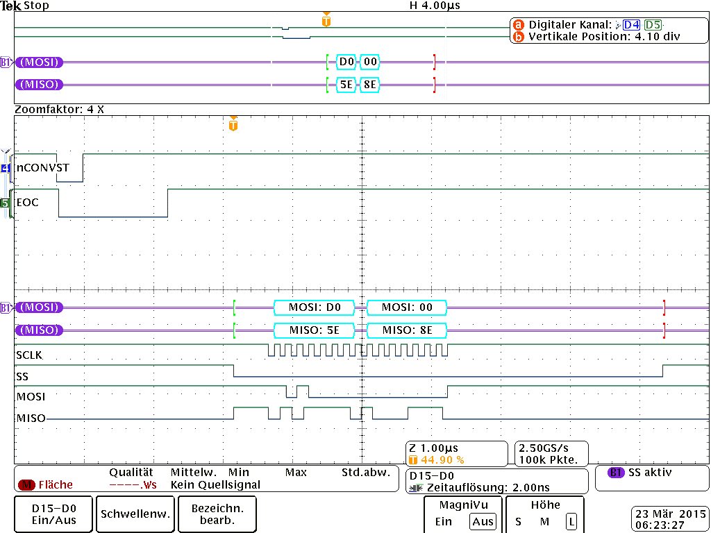

I am currently working in an analog-to-digital converter ADS8332 and have problems with the use of this IC. This IC communicates with the microcontroller over the SPI. I'm a novice in this area and I hope the community can help me.

Then I send to the selection of channel 0 this hex stream:
SPI_I2S_SendData16(SPI1, 0x0000); /* See Datasheet ADS8332: Give ADS8332 command write into command Register "Select analog channel 0" */
Finally, I give the cyclic instructions to send the converted value from channel 0 (See Figure 1):
SPI_I2S_SendData16(SPI1, 0xD000); /* See Datasheet ADS8332: Give ADS8332 command write into command register "Read Data"*/
Figure 1: Give ADS8332 command write into command register "Read Data"
My problem is that the MISO signal is always changing, although I always channel 0 query and the channel 0 is connected to a defined voltage potential. The MISO signal is constantly changing and is no proper digital values. I do not know what I'm doing wrong. Please help me...
  • Oleg,
    Looking through the code, you seem to have configured the part correctly for Ch0 and the EOC signal in your scope capture seems to be working as expected.
    How are you generating the CONVST signal?
    Could you please share the relevant portions of you schematics to help narrow down on the issue?
    Thanks.
    Sandeep
  • Hello Sandeep,
    I have solved the problem. I had an error in my initialization of the ADS8332.
    In my ADS8332-Initialisierung I forgot to wait to the BUSY-Flag (until it goes low).
    My proper initialization is:
    void init_ADS8332(uint16_t ads8332_configuration_setting)
    /* initialize ADS8332 */
    GPIO_WriteBit(GPIOB, GPIO_Pin_6, Bit_RESET); /* nCS set low */
    SPI_I2S_SendData16(SPI1, ads8332_configuration_setting); /* See Datasheet ADS8332:
    Give ADS8332 command write into cofiguration register */
    while((SPI1->SR & 0x80)!=0); /* Wait when the Busy Flag (BSY) in SPI status register (SPIx_SR) set */
    GPIO_WriteBit(GPIOB, GPIO_Pin_6, Bit_SET); /* nCS set high */
