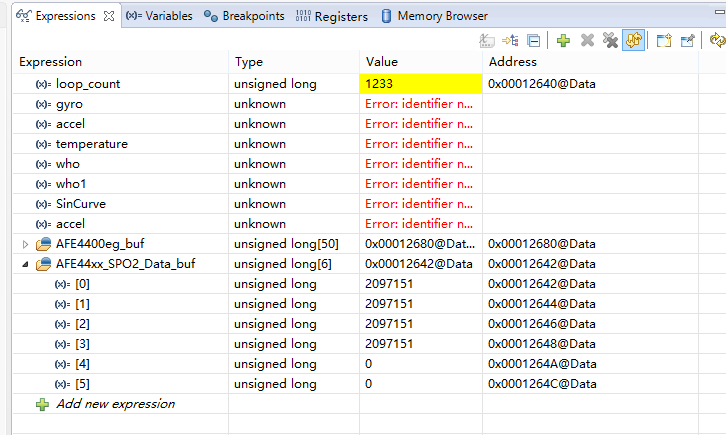

3.After initialization, I try to read back some values:
	   AFE44xx_SPO2_Data_buf[0] = AFE44x0_Reg_Read(42);  //read RED Data
	   AFE44xx_SPO2_Data_buf[1] = AFE44x0_Reg_Read(43);  //read Ambient data
	   AFE44xx_SPO2_Data_buf[2] = AFE44x0_Reg_Read(44);  //read IR Data
	   AFE44xx_SPO2_Data_buf[3] = AFE44x0_Reg_Read(45);  //read Ambient Data
	   AFE44xx_SPO2_Data_buf[4] = AFE44x0_Reg_Read(46);  //read RED - Ambient Data
	   AFE44xx_SPO2_Data_buf[5] = AFE44x0_Reg_Read(47);  //read IR - Ambient Data

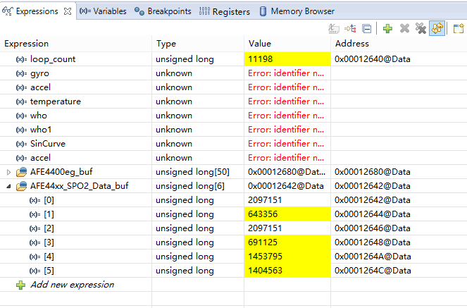

When my finger is NOT on the DCM03, the values are shown below:
When my finger is on the DCM03, the values are shown below:
As you see, the RED Data and IR Data are always as 2097151.
Why?

  • Hello Di Jiao,
    It seems like the gain setting of 1M is high that it is saturating the signal at the output of the TIA.
    DCM03 has a larger area photodiode and a larger area photodiode results in a higher signal current.
    Higher signal current with 1M gain is saturating the signal chain.
    You may want to reduce the TIA gain like 50K to begin with.

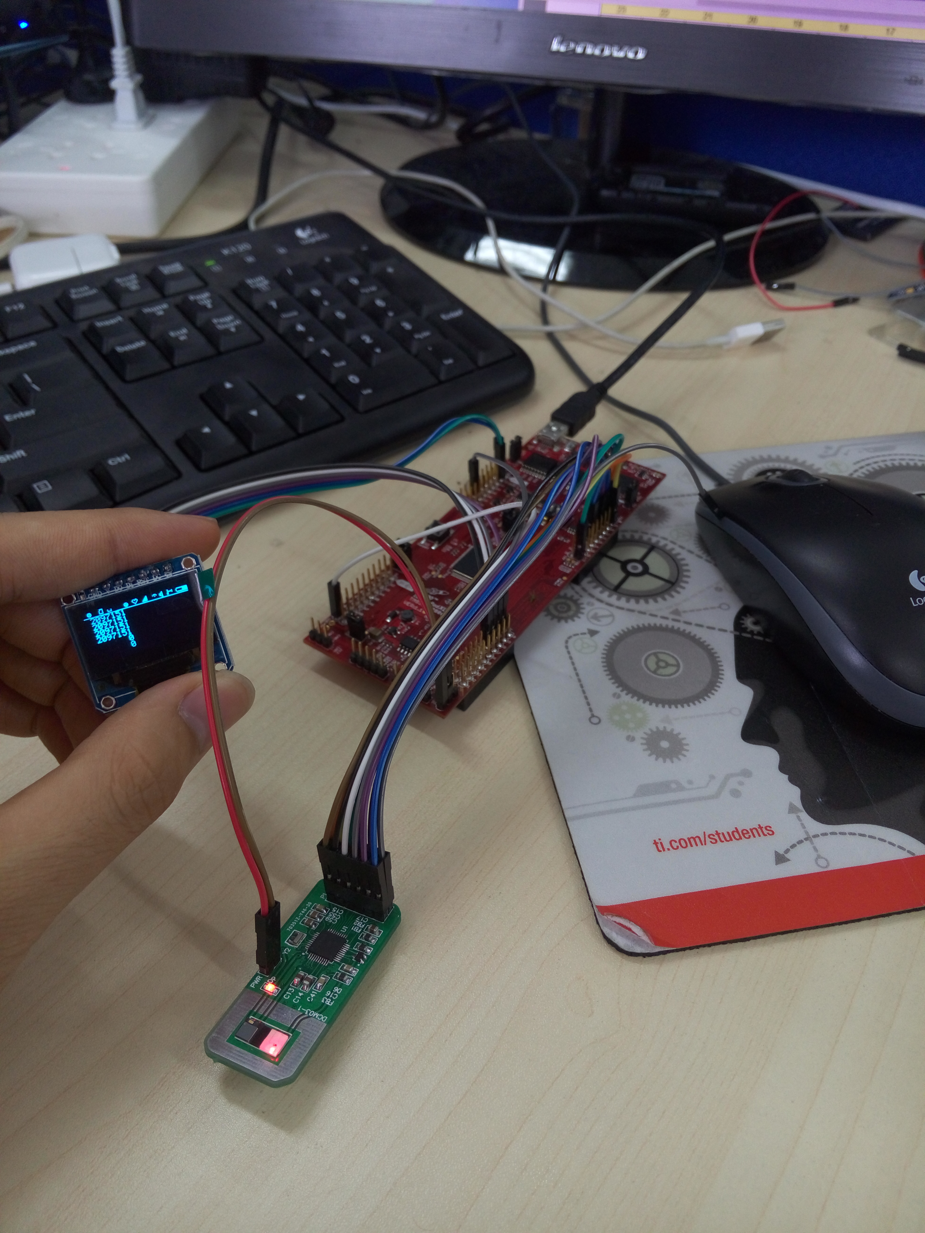

  • Hi  Aroul,
    Thanks for your kind help.
    I take your suggestion and tried to test the AFE4400.
    I have several questions and I really hope you would take a look.

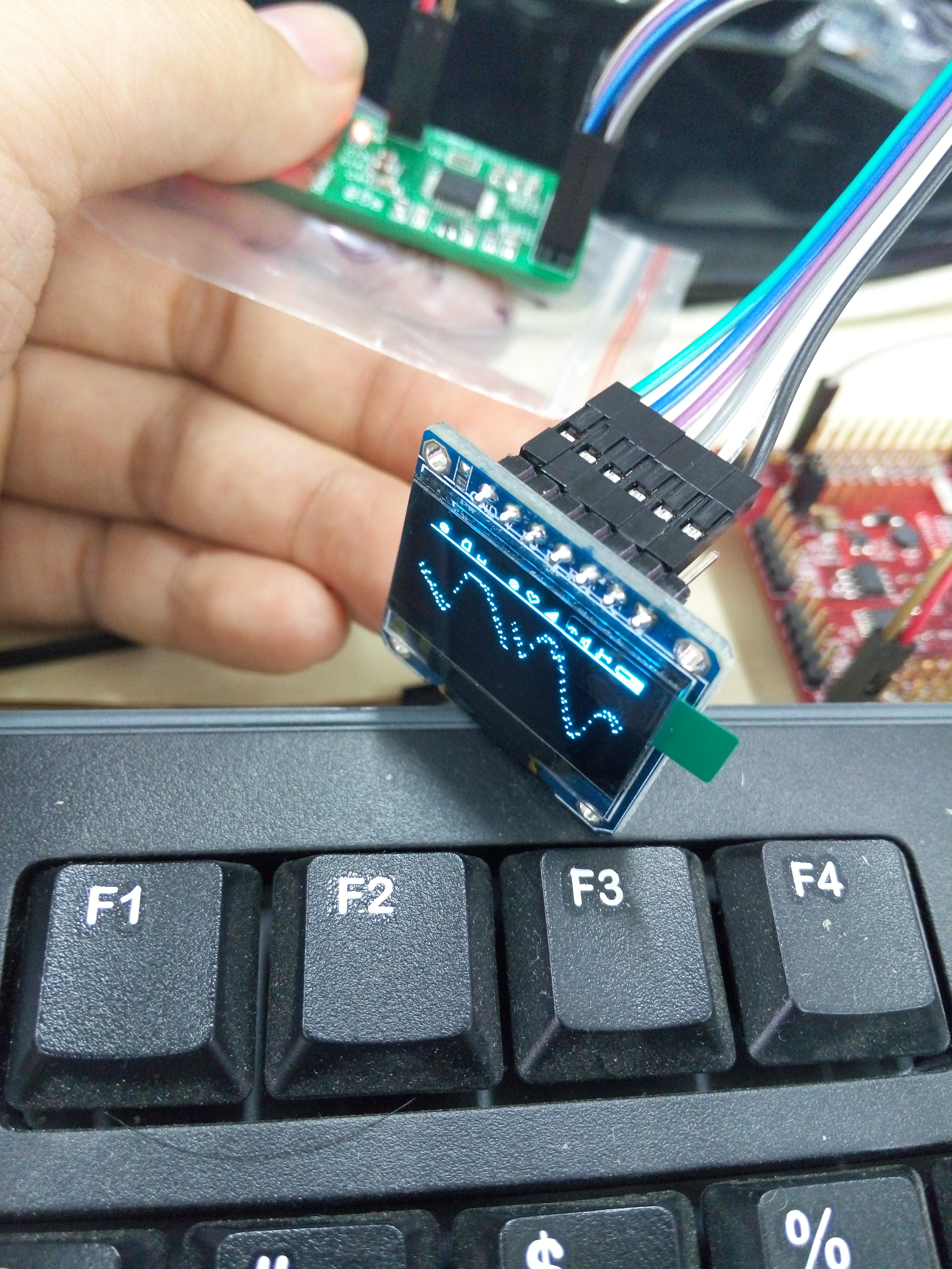

    3.I  gain setting from 1M to 50K and I find read IR Data can vary.
    And I remove it's DC component roughly and show the signal on the OLED and I think I have got the correct signal.
    4.But the RED Data remains 2097151. I don't know why.
    5.Because I made the hardware myself and not sure it is correct.
    So I want to make sure the hardware is no problem then I will try to do the software.
    Thanks again for your kind help.
