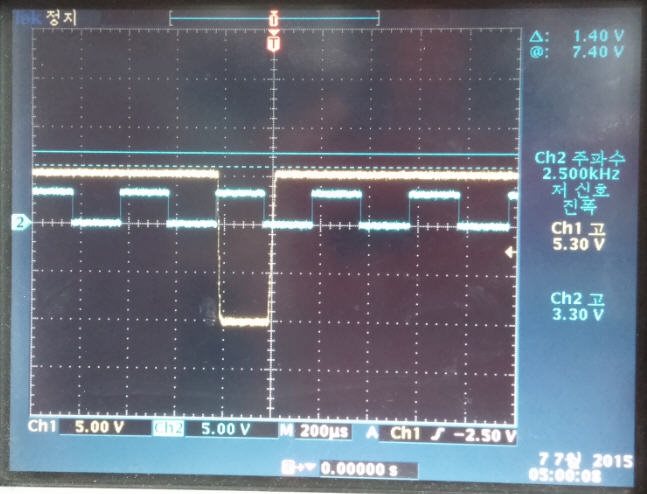

The problem is a DAC function (TLV 5638), sometimes output of the TLV5638 goes to 0 V when two outputs are used.
It seems to be random when i observed this problem.
To solve it, I changed a lot of things such as using external ref. voltage, using external 5V VDD, decrease SPI speed, increase delay time, etc.
Due to these efforts, time interval of 0V problem is reduced, but it is not perfectly solved.
The remain problem is that 0V response still occurred randomly and is about 250 us when the control rate is 4 kHz.
It looks like that sometimes a command (Write data DAC A and update DAC B with BUFFER content) is not working because about 250 us is a period of the 4 kHz control rate.
When i write a command (Write data DAC A and update DAC B with BUFFER content) twice with fast mode/normal operation value, 0V time interval is reduced about 40 us.
About 40 us is my best results. but, still, i did not solve it.
I wonder whether the TLV5638 chip has a flaw or not.
Anyone have an experience of it?
please let me know what do i do to operate TLV5638 perfectly!
Please give me answer  (how to design TLV5638 circuit  and related codes).
I did my best, and  about 40 us  of 0 V   is still remained problem.
p.s>  Why internal ref. voltage occur the problem (similar to shut down of the TLV5638 chip)

  • Hi Sehun,
    This is definitely not the expected behavior while using the device.
    Is it possible to share some oscilloscope captures of the digital interface? Ideally of when the output becomes 0 V. If its random it will be difficult to capture for you. Analyzing the SPI interface on the oscilloscope will still be very helpful.
    Also, it it possible for you to share a sample sequence of codes that you are sending to the DAC? This will give me some insight as to what data the DAC has in its registers while trying to update.
  • This is an image which captured from oscilloscope.
    Throughout twice transmission code (Write data to DAC A and update DAC B with BUFFER content), i reduced 0V behavior about 40 us.
    I will reduce SPI speed much more such as  300 kbps  which an example did (found in the internet).  I hope  this approach may solve this problem.
    Nevertheless,  since i am a control engineer student,   i want to know  what a reason of this problem is !!!
    Someday, i may change a TLV5638 (having the problem) with another TLV5638,   if reduction of the SPI speed do not solve this problem.

  • Until now, i used DSP's SPI funciton (SPISIMOA, SPICLKA, SPISTEA).
    Refer to a document (academic.cankaya.edu.tr/.../Module7.pdf)
    I changed a SPISTEA pin as a GPIO output pin. Then, i give a /CS signal manually (like the above document.).
    Now, it seems to be DAC output ok.
    Maybe i should observe the DAC output signal very long time so that the 0V problem is really solved or not.
    (The frequency of 0V problem is decreased, but 0V problems are still occurred occasionally and unexpectedly.)
    Several things i have questions.
    1. power supply for the TLV5638.
    I purchased 28335 module from the company in korea and when 5V (from the 5V output with 3A DC adapter which also provide DSP module power) is connected to TLV5638, 0V problem occurred. Thus, I am using DC power supply device now.
    I wonder why 5V in the DSP module cause the problem? It is very curious to me.
    2. Delay time for SPI comm.
    In the above reference doc. (academic.cankaya.edu.tr/.../Module7.pdf)
    They used a following delay function.
    for (SPI_i=0; SPI_i < 100; SPI_i++);
    When I tested it with various delay time, delay time is sensitive to 0V problem (maybe SPI comm. or TLV5638 update problems.)
    Please give me advise how to design or calculate proper delay time in order to operate TLV5638 well (with respect to SPI speed, etc).
  • Hi Sehun,
    Thank you for providing all of this information. I cannot verify the validity and accuracy of the document you quote.
    Can you share an oscilloscope capture of DIN and SCLK?
    Do you notice the a voltage drop on VREF during the output droop?
