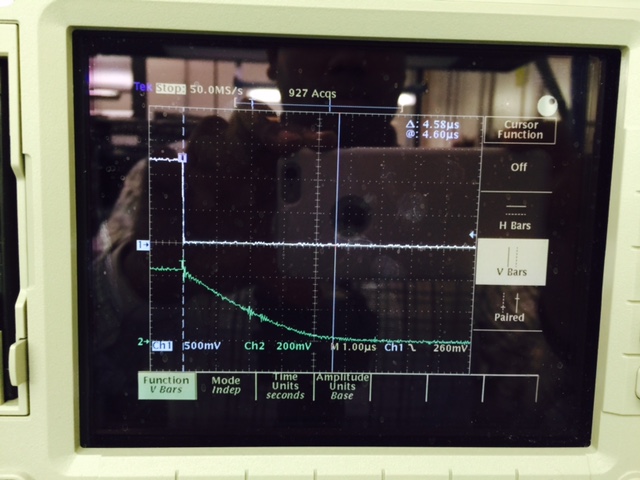

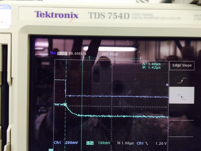

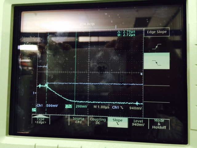

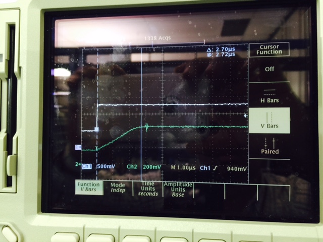

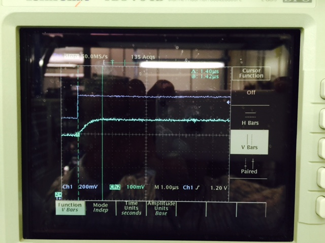

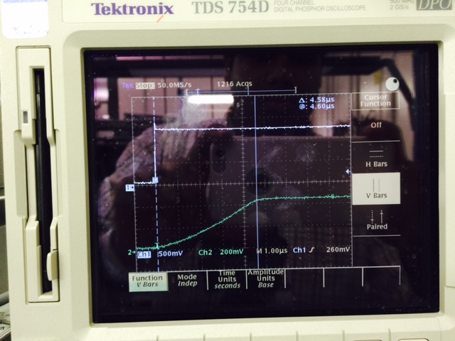

Let me ask you a question about high speed DAC like DAC900/5652, THS5651A.
Q) Response time between “External Reference change” and “IOUT”
In external reference mode, we can change the reference voltage from 0.1 to 1.25V. (For example DAC900)
When we have changed the voltage, how long is the response time of IOUT against the changing?
For example, how long does it take for IOUT to follow the changing of external voltage, from 1.25V to 0.125V?
The aim of this operation is to keep resolution even if the signal amplitude is reduced.
Thank you very much for your support.
